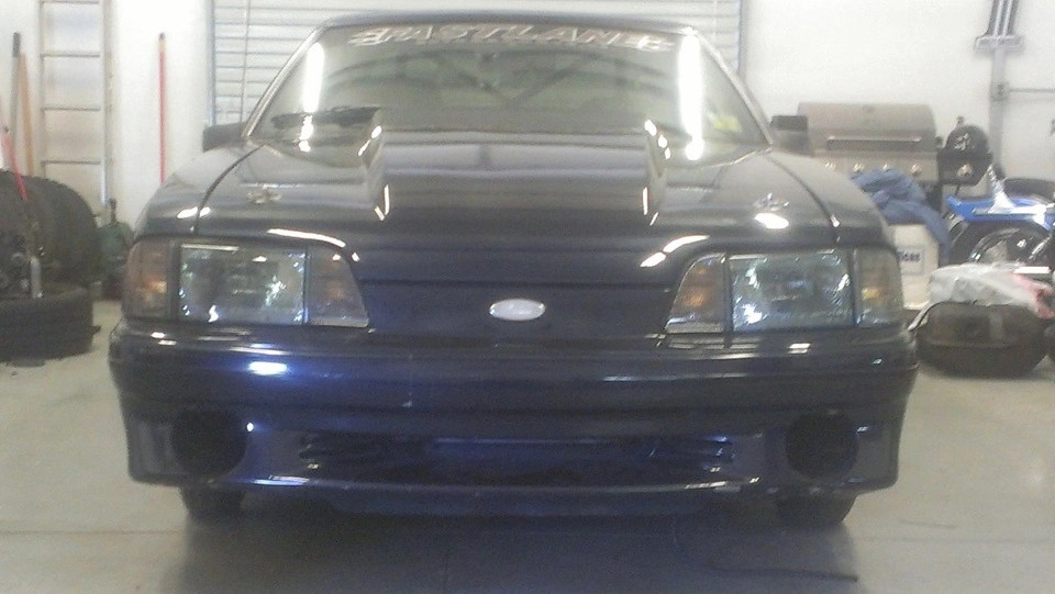

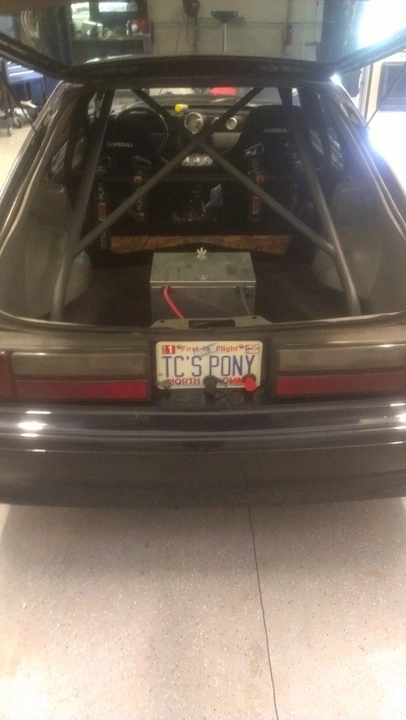

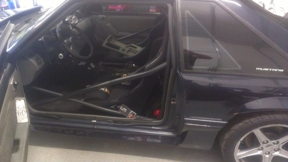

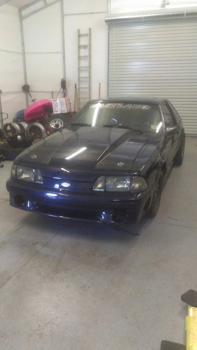

couple pics of the newest ride
Reactions: ratio411
i'm sure you have seen it there. this was Taylor's (the guy at the sales counter) car for the past 10 years. he bought both my 01 and my 11 GT from me
I thought so! I was up there a few times last winter/spring, my buddy was getting work done on his '05, cams, shifter, full exhaust, intake, ect.
