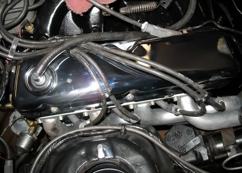

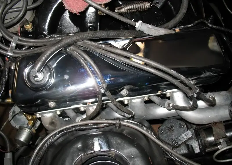

I have a set of 1 3/4" Accufab's that fit fairly well, although they are now a little over $500. I did do a little shock tower clearancing, as I wanted the motor to be installed as low as possible in the engine compartment. That sets the motor tighter into the "V" of the shock towers and thus even less clearance, especially since my heads have raised ports. The clearancing was relatively minor and could be undone from under the fenders should the need arise. The ground clearance borders on phenomenal.
If you seriously want to do this yourself, I can provide other pics of these headers in and out of the engine compartment.
