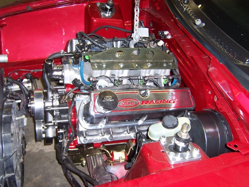

I never had any problems with mine, but I installed the engine and trans separately. You need to use 302 motor mounts, the 351 is the same engine just taller and wider.
Here's pics of both mounts. I don't have a tubular k-member in these pics, but I have one now and had no problems installing it.
