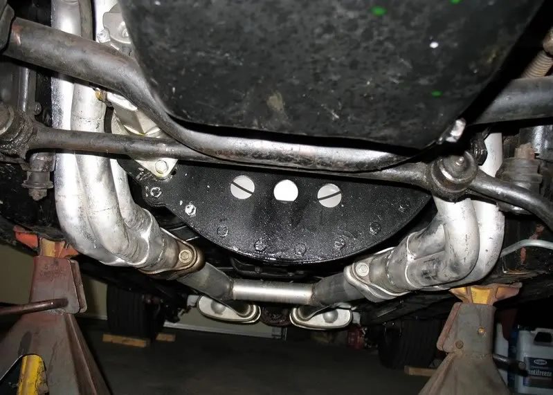

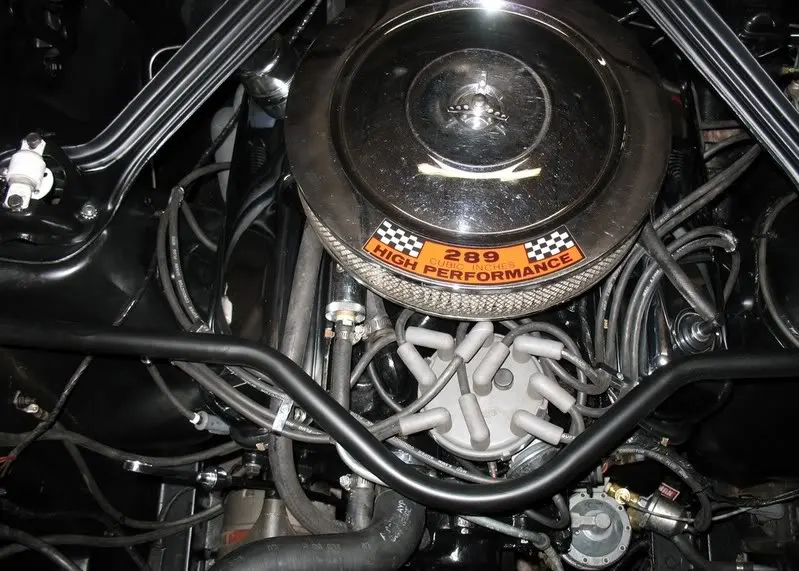

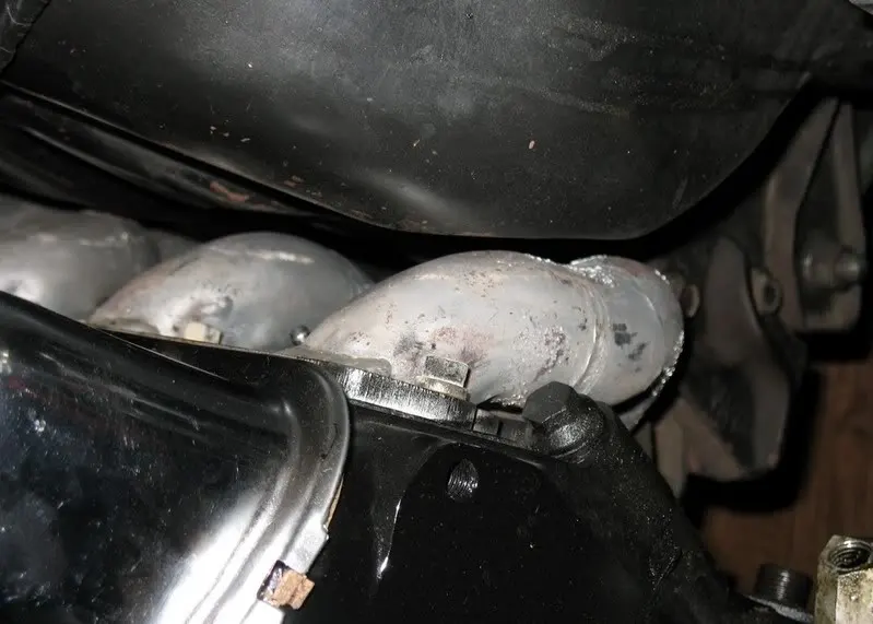

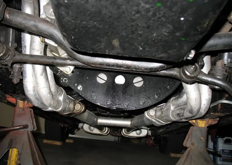

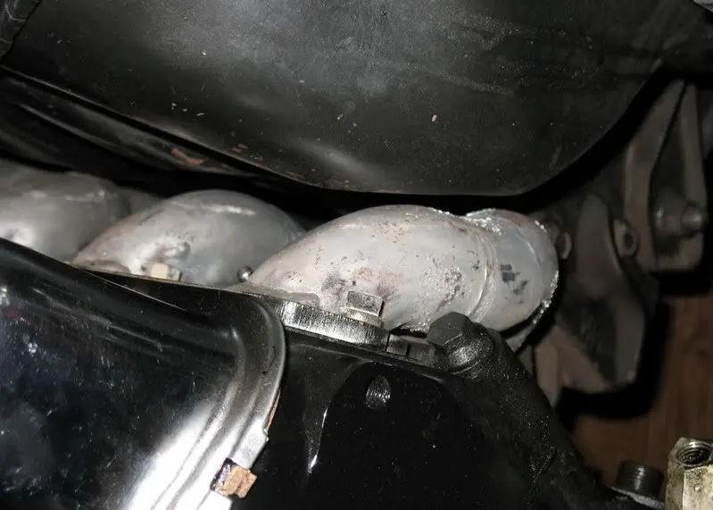

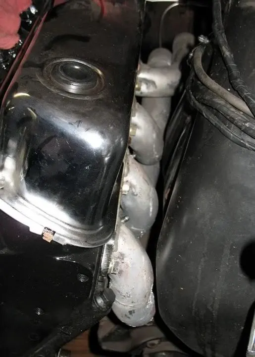

You WILL need conversion headers. There is practically zero percent chance that a 289 header will work without extensive modification of it or the shock towers. Header fitment is tight. That is the toughest part of the conversion. Here are my Accufab conversion headers:

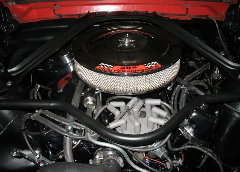

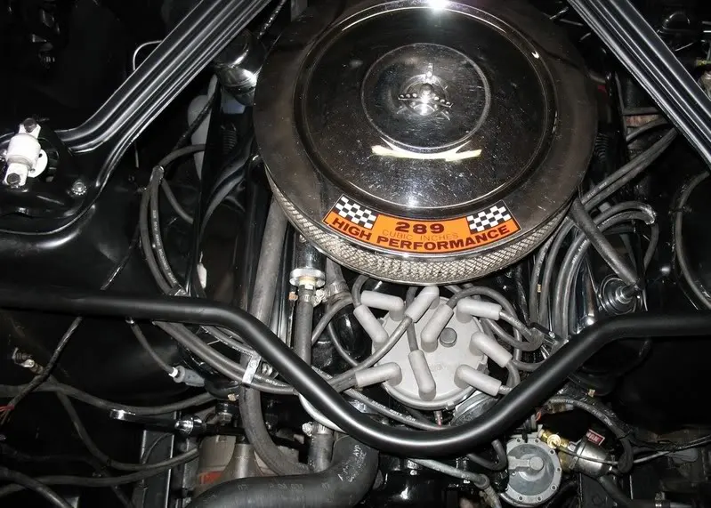

Dressed to look like a 289 (old photos):

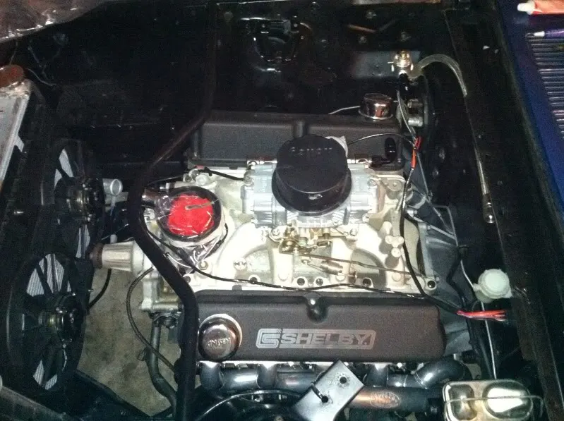

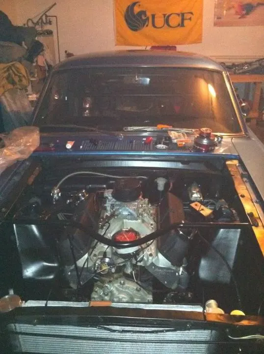

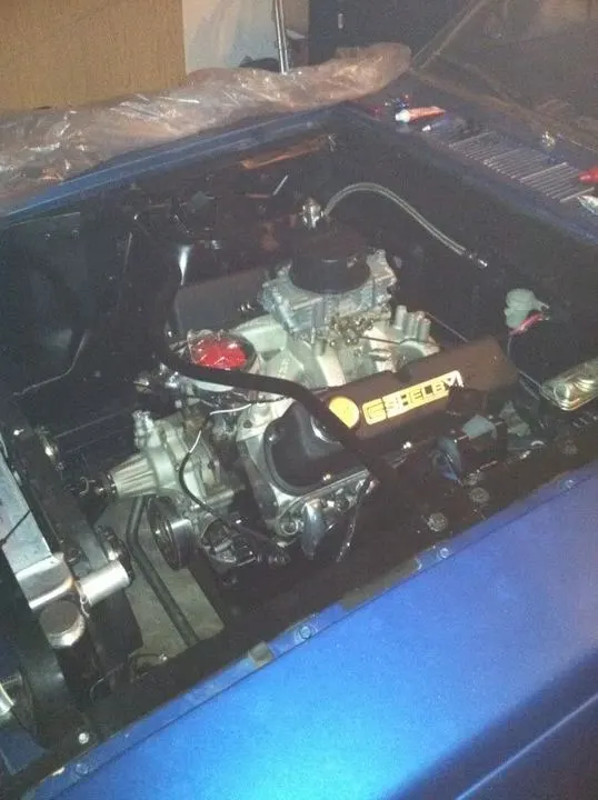

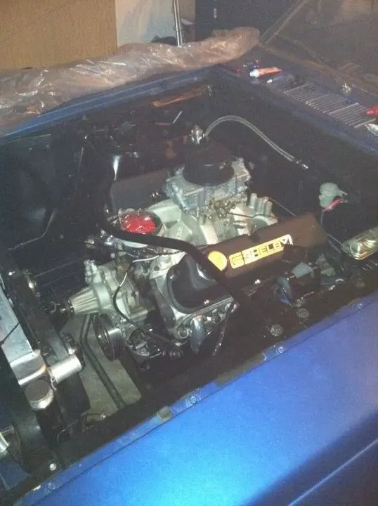

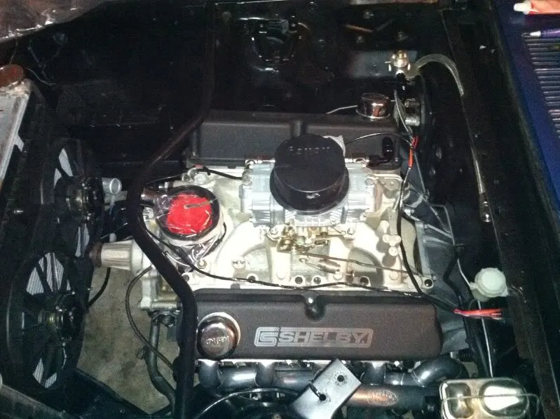

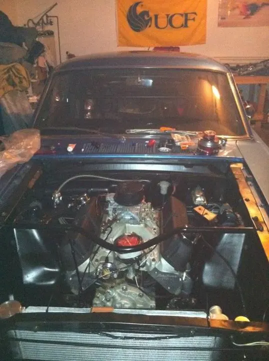

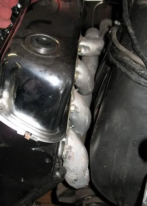

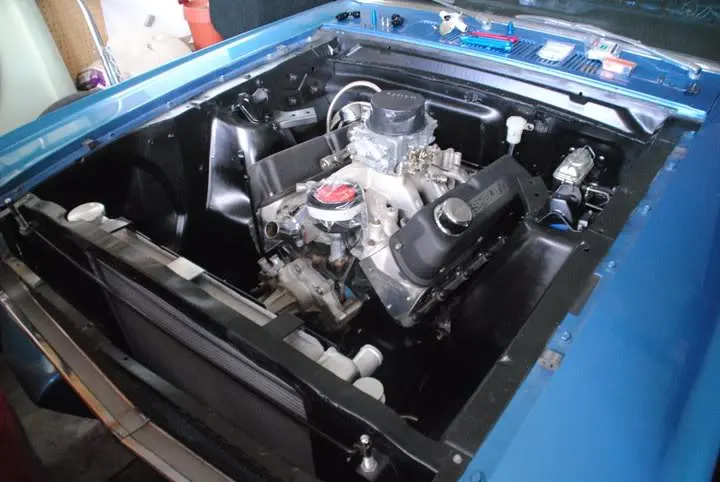

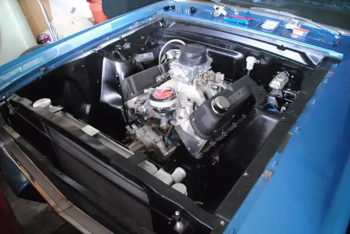

here's the 408w with headers installed in my 65 fastback...crappy cell phone pic but its coming along well...
before headers:
After headers:
Im hoping it should be alive and running in a couple of months!
