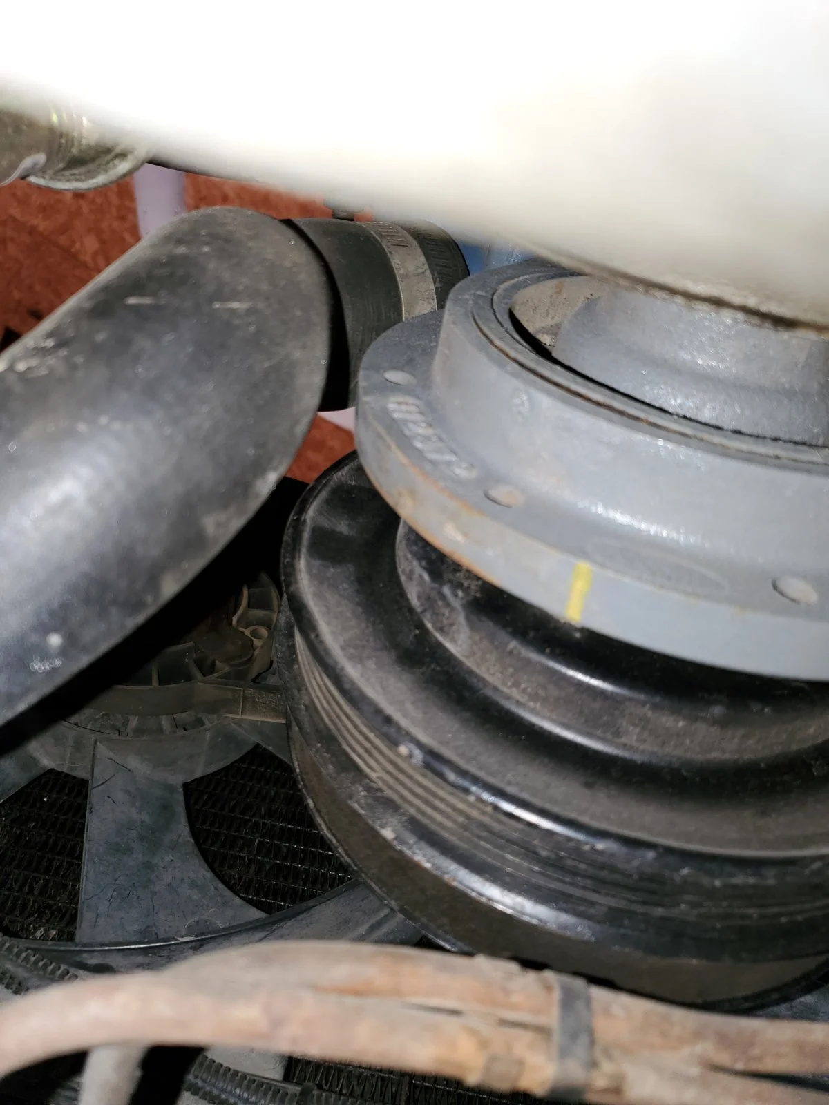

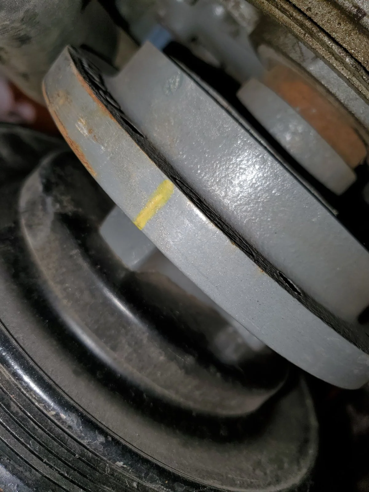

So I had a better look and yes there are some marks hardly visible, no way in hell you would ever see them with a strobe light unless there some way to revive them.
I seen a 20 and 30 degree mark and his yellow mark is before the 20degrees but I cant tell where exactly as numbers are visually gone.

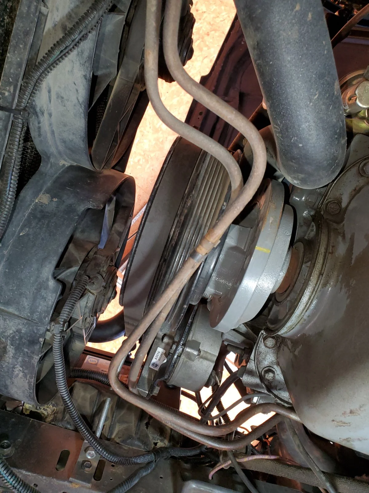

Looks like I'll be replacing the balancer seems like a fairly straightforward job hoping I have enough room to use puller and installer without having to take to much apart what's your thoughts?

Usually it's getting the impact in there and the install tool that take a lot of room. I've never gotten out one out without pull the radiator. Those marks aren't great. I generally mark them with white out.

Get some sand paper and some clear acrylic nail polish. Sand the paint off and coat the area with the clear coat. I had to do mine. Once you sand it the numbers will start to show up. My paint was so flaky I removed it with a razor blade and then hit it with 320 grit sand paper. I couldn't remove the balancer. ( now that I think about it ). My condenser, radiator, and intercooler share a mounting bracket and are a pain to remove.
Think I can make it work, put wire wheel on grinder cleaned it up and was able to make some sense of it, his mark was at 12degrees whether it's actually there I'll have to get a light n find out, thinking I can probably use a chisel and hammer in fresh notches.
