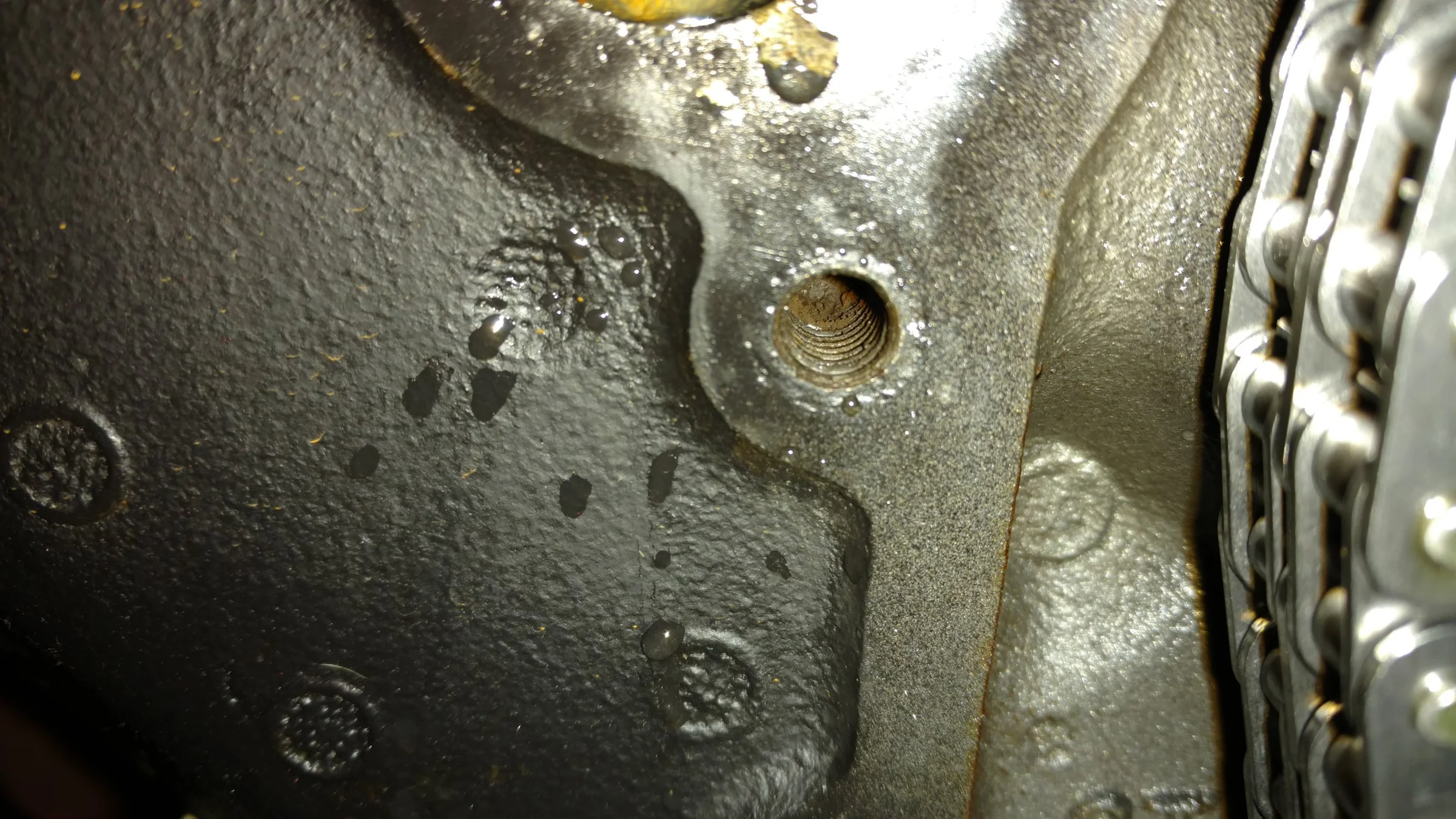

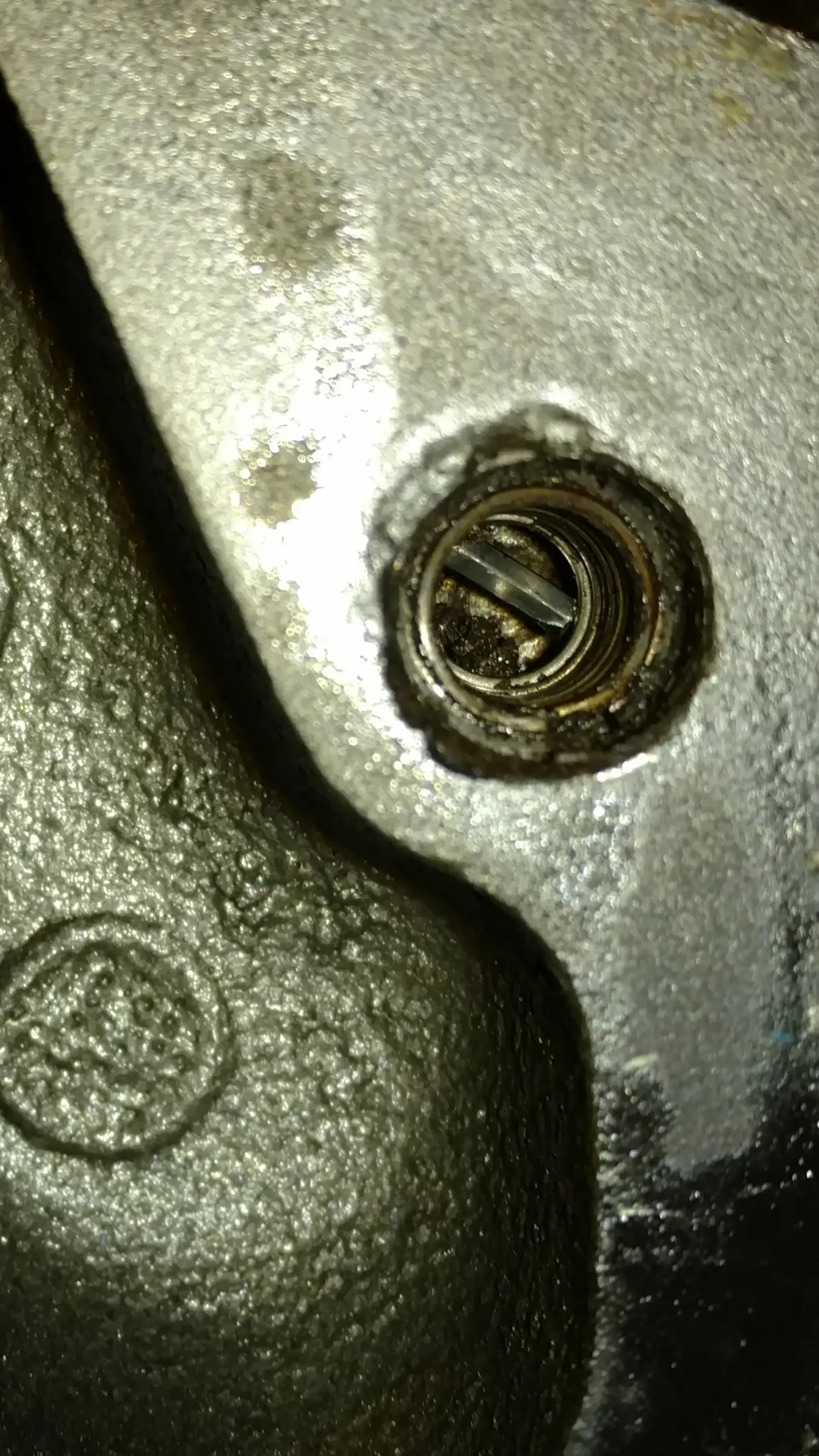

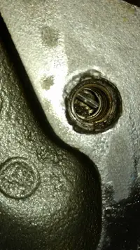

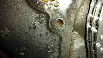

Hey guys, I have a huge problem. I have, what I thought was a successful Helicoil install, but after installing water pump water appears to be leaking past the bolt. What are your guys suggestion, on how to finish the fix. First picture is leaking side of water pump. The second picture is the opposite side same bolt hole.
Thank you, is the leaking normal just with water added to the motor? I thought it was strange that it was just the Helicoiled side leaking, once the motor was put back together. Any suggestions on great thread sealers?

Thanks for the suggestion, I believe my biggest issue was the Helicoil had that metal thread bent over keeping the bolt from seating completely against the pump. I'll hopefully finish it up tonight and post updates, thanks for suggesting and insight!
The metal tang needs to be broken off to complete the installation. A 1/4" pin punch or plain rod and a hammer be used to break the tang off. Then you get to fish the broken tang out of the hole. A small magnet may work for that; Home Depot has small super magnets for about $3 a package
