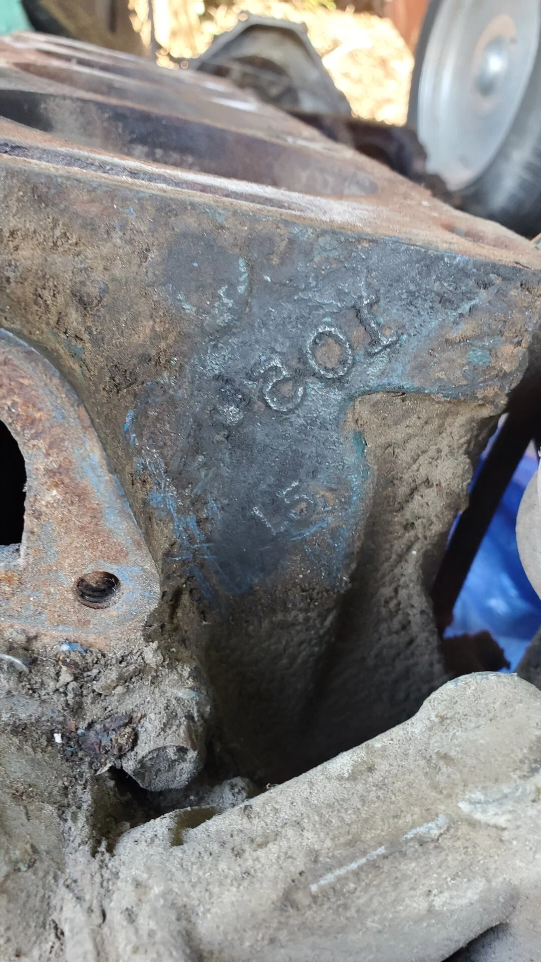

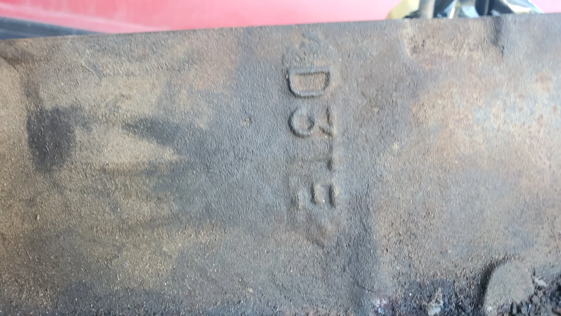

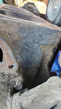

Hello im new to this forum and I was wondering if anyone has swapped a 391ft engine into a foxbody? I recently got ahold of a 391ft or 105 mirror engine and I've read good things about the block. I know people will say I should of just stuck with the 5.0 or a 351w but I'm trying to do something different. Just wanna know if it's worth it to build or of i should just sell it and get another engine

Do you mean a 390 FE series engine? Also, what is a 105 mirror engine?

And the 391 is from the ft family for the bigger heavy duty truck engines like the ones from uhaul
yep basically a heavy duty version of the 390FE engine. the biggest thing is the crank in the FT engines are forged where as in the FE engines tehy are cast. you will have to do a bit of machining to the crank snout if you want to use the passenger car balancer.
