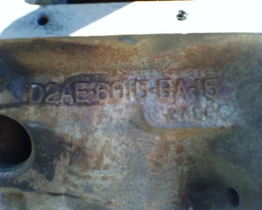

I just picked up my 1972 351W block this morning. Still need to send it to the shop to get it cleaned, but i want to start planning ahead and was wondering if i should stroke it out to a 393, 408, or a 427 ??.. Which will be most reliable? I'm looking for about 400hp street/strip car.
