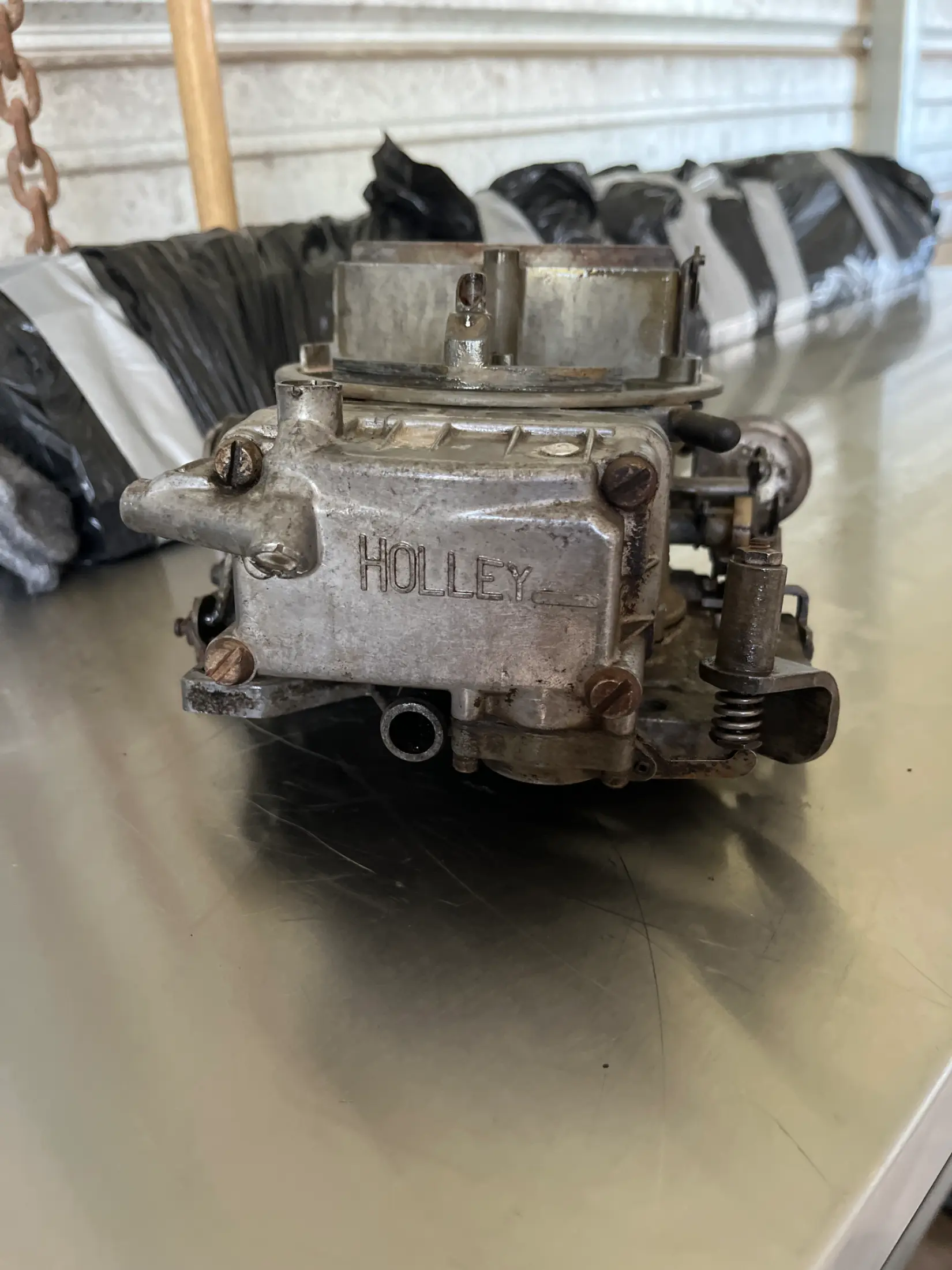

I’m asking for some help with picking a carburetor for this build. I was told 650 cfm is the way but I would like more input.
I have my dad’s old Holley

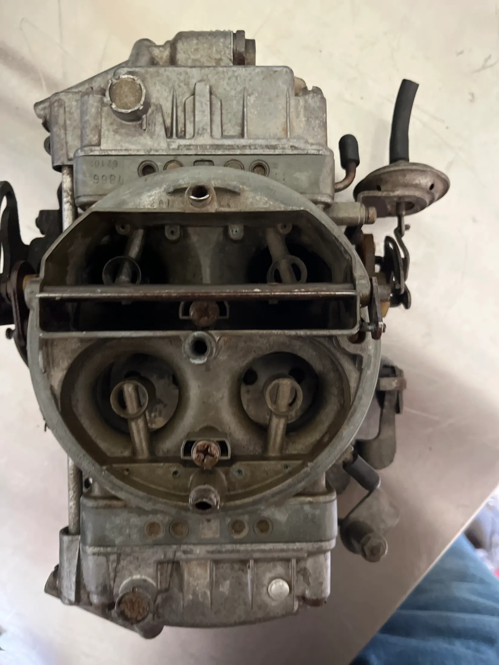

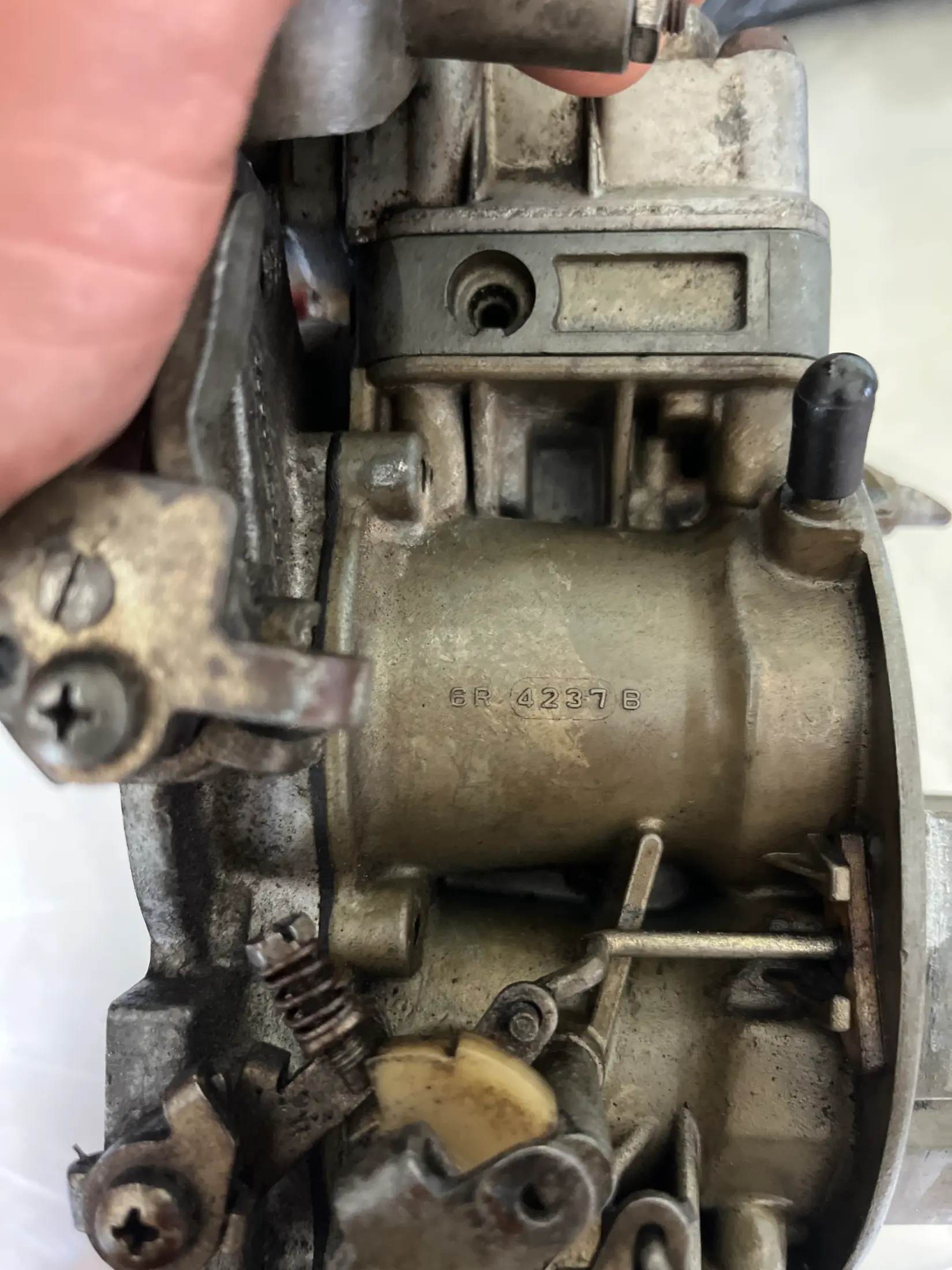

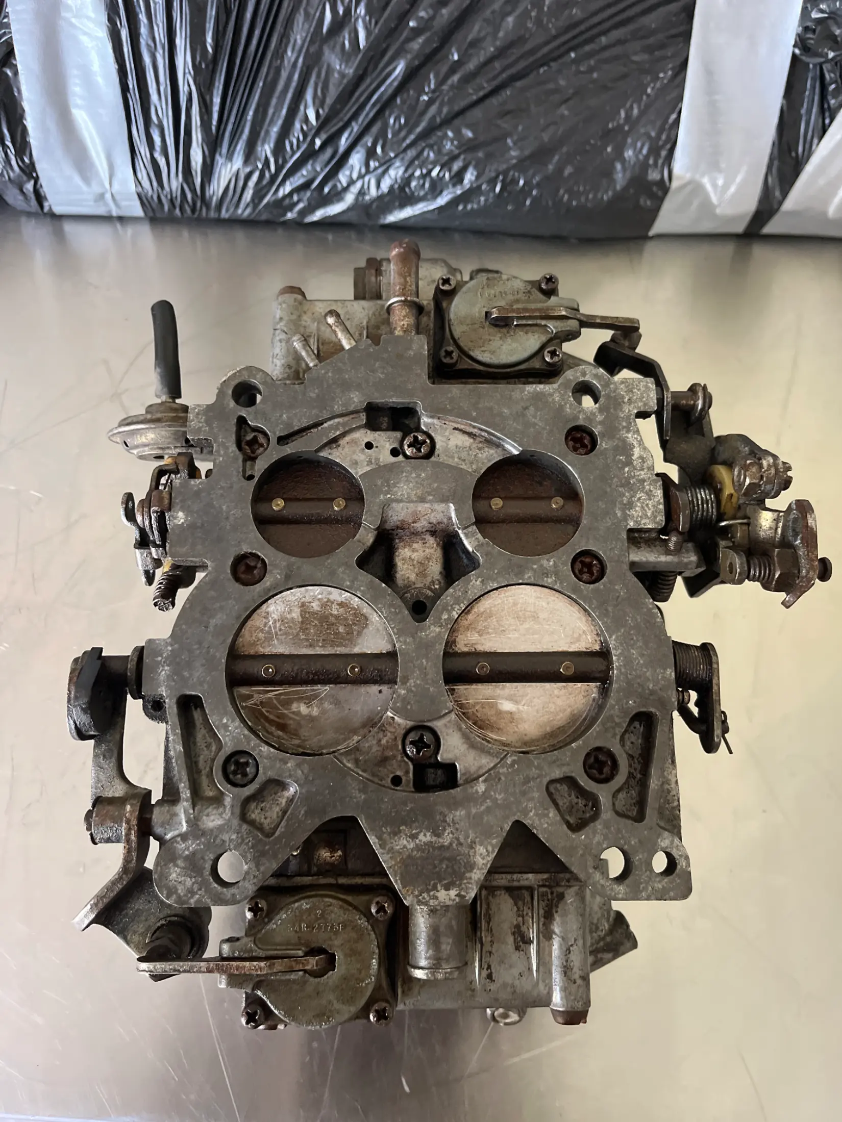

I do believe it is a double pumper. serial #6r 4137 b. Carb was in bad looking shape when I found it. Wondering if it would be worth rebuilding. Would it feed my stroker enough. I feel like it would be cool to have it on my dads old four eye

What's the expected max rpm you're looking to turn with your combo?
And, at least to me (a carb guy), that carb looks to be in pretty good shape.... not totally clapped out looking like a lot of that vintage carbs. And it looks complete too. Cleaned up and properly rebuilt, it should work great, imo. The annular discharge nozzles are a big plus also.
But I totally understand the convenience of just unboxing a brand new carb and not worrying about the rebuild process and results.

I have had more problems with what I will call " worn out " carbs throughout my car life..... No matter what you do to them they just don't work right... Unless your building a matching number car of some sort, I would get a new carburetor......

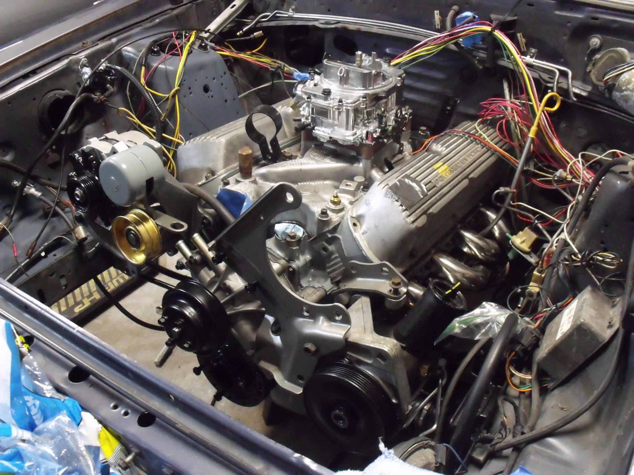

I am going to give this 500 CFM Summit carb a try on my 030 over 302....
For street use, I am a believer in smaller is better with carbs.... A bigger carb does NOT equate to better...

Were talking street cars here..... As a younger guy we used to put too large a carb on our cars... Bigger is " faster" right?? Of course the Speed Shop was more than happy to sell us new larger carbs anytime... LOL..... I think your 650 CFM choice is a good one...
My calcs were for a max RPM of 5500 on my 302....

As far as that carb is concerned, it's a crap shoot, if you've played with carbs as I have, I'd tear it down, toss a kit in it and see how it works, although, and I'm gonna toss a caution in here, firing up a 'new' engine on a 'unknown ' carb without carb tuning experience is tricky but not hard.
I rebuilt the carb on Brand X, it's old (likr 1953 old) but it had a warped lid so bought a 'guaranteed ' rebuilt one (can't get new one's) works good, got lucky, you could get lucky too.
