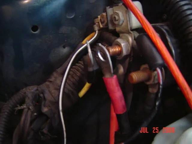

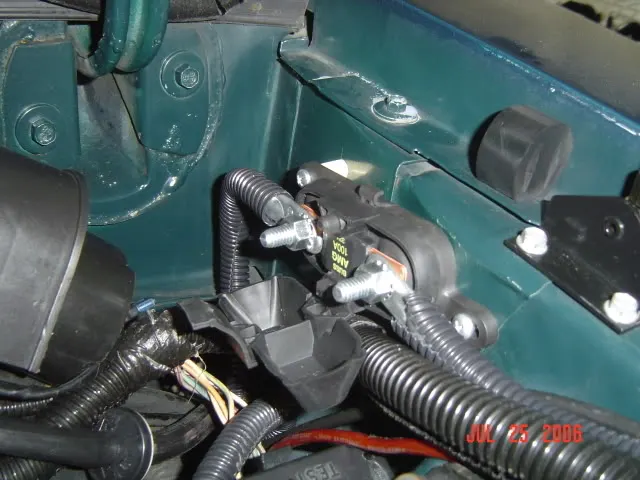

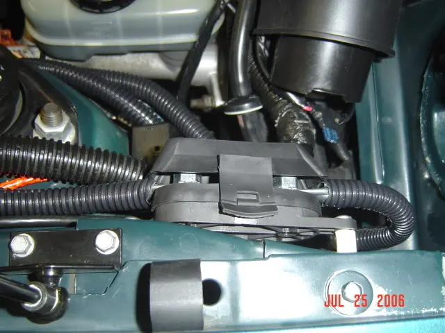

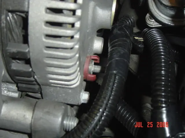

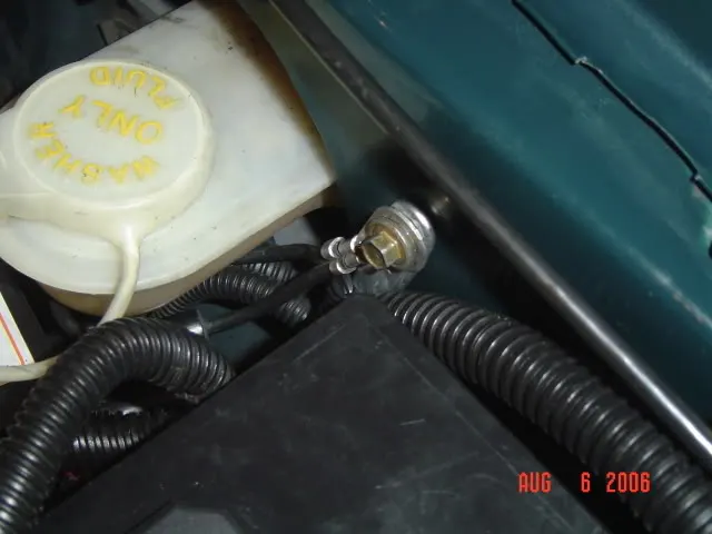

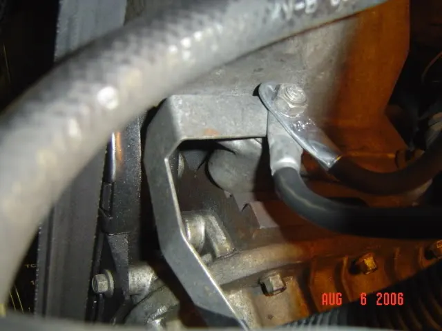

Here are some pics I took of my install. Remember mine is a 4 cylinder, so location is on opposite side of 5.0. Hope it helps some.
