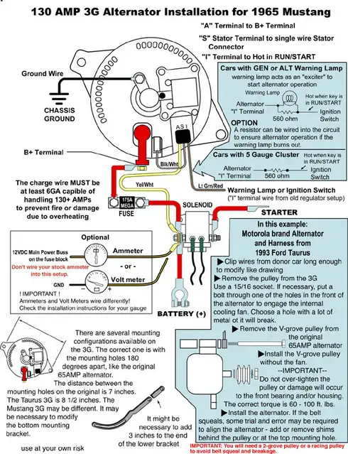

Picked up a Tuares 3g alternator and I'm finally getting around to converting, though I have a couple of questions.
Got the pulley off of both, and as a shim I used the 1G alternators lock washer and then put on the pulley and torqued it down to 77lbs. Is 77lbs enough to satisfy safety requirements? I figured if the 1G used the lock washer then I could use it again as a shim, then the pulley, followed by the pulley nut.
Found a diagram on the 3G conversion and obtained the 175 amp mega fuse. My next question is about the 'I' terminal wire that is supposed to go to the starter switch that is hot in run/start. What and where is the starter switch?? (starter solenoid?)
It appears I won't be using any of the old alternator wires (correct me if wrong please), nor my electronic voltage regulator. I'm not concerned about deleting these wires as I'll be getting one of those EZwiring 20 circuit harnesses probably in a few months. I just need to figure out where the starter switch is..

Are you looking for the starter solenoid? It's at the end of your positive battery cable mounted on the passenger side fenderwell between the battery and the shock tower.

I apologize, I have the "A" wire running back to the alternator per another diagram I found. (one that goes to B+ terminal)
I'm trying to figure out the wire labeled "I" on the alternator - where it goes to. What colored wire goes to the ignition switch?

You're talking about where to route the LT GRN/RED wire coming off the alternator right?
If so I asked a similar question a few months back in this thread.
http://www.stangnet.com/mustang-forums/799456-bizarre-alternator-starting-issue.html
Let me know if that doesn't answer your question.
Yes - that's the wire. So it splices into a blk/wht wire where the voltage regulator is on the radiator support. I see i need to get a 560 Ohm resistor - which one did you end up choosing?
And do I have to get a 4ga wire going from the alternator to the fuse block ? (post 6 from your link)
Edit: one of these resistors? 560 ohm 1/2W 5% Carbon Film Resistor pk/5 - RadioShack.com

The wire I spliced it into was also GRN/RED at the voltage regulator connector. If you don't have the ALT Warning light then yea you need the 560 Ohm resistor. I actually haven't bought the resistor yet, was waiting for feedback on that.
As far as the 4 AWG wire goes, I ran my 4 AWG fire through the 175A fuse and then to the starter solenoid. Are you currently using a 4 AWG wire? As long as you have it running through an appropriate sized fuse with the correct sized wire it shouldn't matter how your go about your wiring.

I installed the 560 ohm resistor and found that same 904 Green/Red wire by the voltage regulator. It's just raining too much to continue, but I'll get that connection spliced tomorrow hopefully. (thanks for confirming that too! )
Not sure what AWG wire I am using, it's actually the one from the donor taures car I got it off of, but it may be a 6 AWG and I have the 175 amp mega fuse.
My old setup was GM alternator the p/o installed and it had a ground strap from it to the block. I just hooked that same ground up to the back of the 3G and I'm assuming that's just as good as strapping it to the body as that diagram shows..? then again, the p/o did install a chevy part in this car!

It appears to be working just fine, it's now charging at 13.3-14 volts (13.3 when warm) and holds steady. Think before it was charging at about 12.2 which probably means my battery is on it's last leg.
Bought a $13 volt gauge (temporary solution till I can rewire everything) and installed it plugging into the fuse box, though I do have it on the wrong one as it stays hot when the key is off -so I'll find another location for that shortly.
