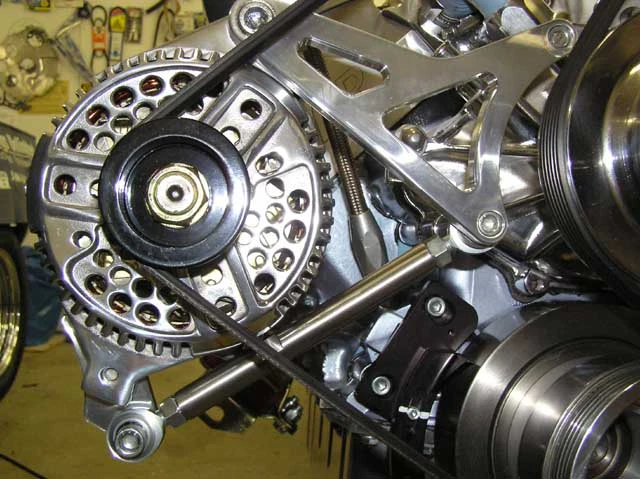

March has a nice bracket for the alternator. It works perfect with a 3G alternator. The March number ist #30025 and costs approximately 100 bucks.
Here is a picture of my setup. I installed the alternator upsidedown. Not the standard installation.

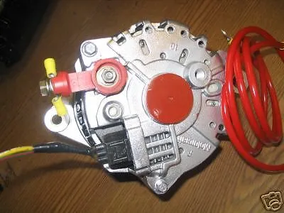

LMAO at the guy selling alternators as remanufactured, that have painted DE and SRE frames and the original stator woundings..... This is rebuilt? NOT remanufactured!!!!!!!!!!!! WOnder what 'new' parts are actually in that thing? If you asked, he probably wouldn't reply.
Here's another alternator by the same seller. Notice the silver paint. He even painted the mounting areas that are for ground. Also notice the dirty used regulator, which btw is the wrong regulator for our app > The white regulators have 2.5sec LRC delay. A little cam will keep this from charging correctly at idle. Also, most of the 3G alts that came with white regulators are rated at 110a. ... Our app needs a grey regulator with no LRC.
From the looks of this, it's a used alternator that he disassembled, cleaned, painted, then conned someone by calling it remanufactured.

Is that a milk carton lid he's using as a SRE bearing cap? and where's the power terminal extension's cap? The housing's painted silver. Is that a used connector harness with black electrical tape.. this seems odd as well, because he should have access to parts like that for cheap.
Maybe it's just me and the fact that I'm in the automotive electrical business, but this dude's parts are all too obvious to me.
