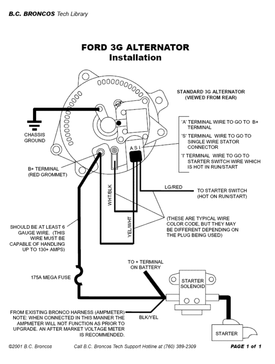

so i did this 3g alternator swap on my 90 mustang 302 carbed. Everything works fine but after its all hooked up it drains my battery. I am sure its my alternator drainign it. Ive narrowed it down to the yellow constant wire on the plug i think. I hooked it to straight to the terminal post on the back since its supposed to be constant. When i have that wire unplugged it doesnt drain the battery but only runs at 12 volts insteadof about 15. Also noticed when it was unplugged the squeeking at hire rpms went away but when i pulgged it back in it started rite back up and it sounds to be coming from the alternator not belt idk.
So my questions are?
1. why is my constant draining my battery and how to fix it?
2. Why is it squeaking.
any help would be great thanks

i've kinda looked around in there but really havent found alot that im looking for. one of my things is the wiring was literally completly gutted out and i installed one of those painless wiring kits for the lights and stuff and all my gauges are aftermarket. Alot of them are saying just tap them in the old harness but my harness is not original and i have a carbed motor. Im fairly positive that its all hooked up rite. is it possible that my alt might be bad or regulator and with the squeeling is it possible when i hook up the regulator it puts a load on the alt and makes it squeel.
Being that you have very little of the original wiring left, here is the best answer...
3g-install-in-85-or-earlier-mustang-gif.532998
