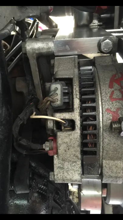

I purchased the Remy remanufactured one for $90. The old one was actually a junkyard find and worked great for about 6 years. When removing it I noticed that it had 2 thin wires that were bridged together and hooked up to the power terminal of the alternator. I want to run a 4 gauge wire from the alternator to the battery but what do I do with those 2 wires?

Do not reuse the two power wires off the original power plug. Tape them off and tuck out of the way. .. ONLY run the 4 g wire with at least a 125 amp fuse directly to the battery or the battery post side of the solenoid.

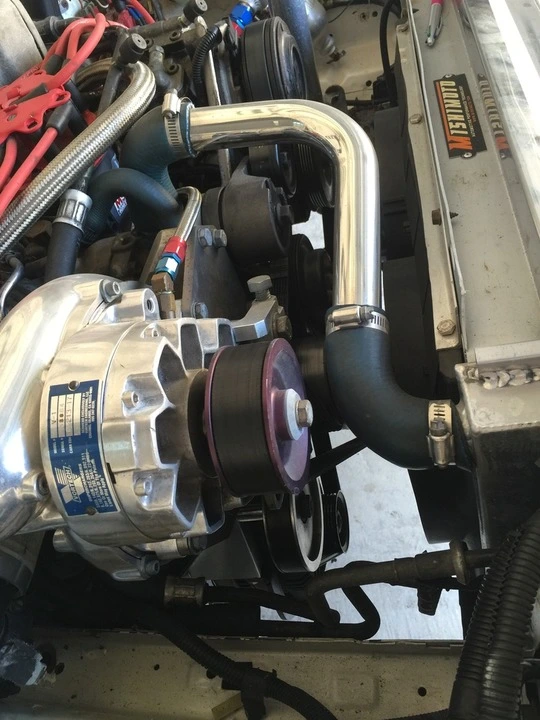

Smog delete pulley with my S-Trim set up. The red lettering was the junkyard alternator that is being replaced with a remanufactured one. They wrote on it to identify it came from them for the 30 day warranty. My starter solenoid is still up front in the stock location.
