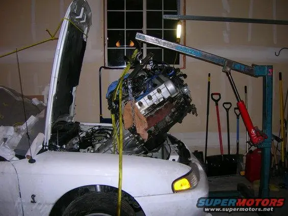

I am removing a 98 Cobra motor from my car, where is the lift points? (where do I hook up the chains to lift it out of the car?)
I don't see a really good place to attach the chains, any help would be great
TIA

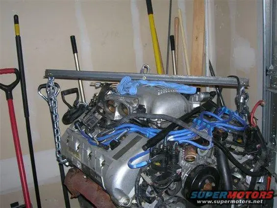

Drivers side head just above the exhaust manifold under the valve cover lip toward front of engine, and pass side same location but to rear of engine. Those are factory lift points. Use a 12mm X 1.75 bolt. One is fine for each side.
I fabbed a neat lift to do it, pretty easy and cheap.
You can use ratchet straps to adjust angle. Without the tranny it would be nose heavy.
