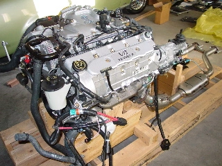

I've got a crate DOHC out in the shop right now that's going in a '67. I've removed the shock towers though, but I would think that a '71 would have enough room with the shock towers intact. The engine is about 29.5" wide at the widest point, which is at the "Mickey Mouse ear" bulges at the front of the valve covers (see photo).
