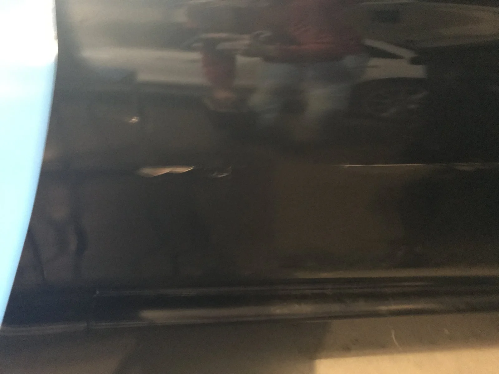

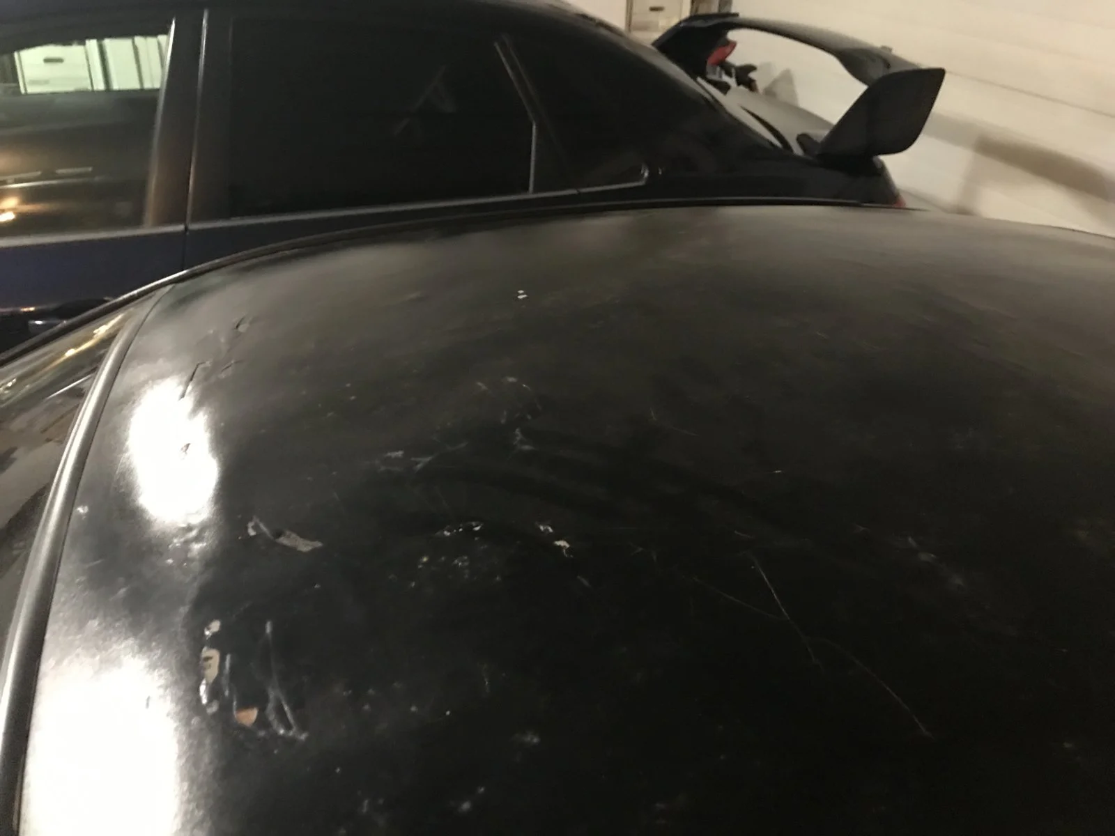

whew that’s a lot of info for my 16 year old mind (and especially wallet) to take in lol. I did for a time consider going the route of the 2V 5.4.. build off a bigger engine and gain some decent torque.. main thing that turned me off of it is the lack of intake manifolds that fit and the adapter plates just seemed like such a bottleneck.. I don’t really trust myself with the experience or budget needed to take a swing at a more major swap, main reason I was thinking of doing a more basic top end build with the PI swap and maybe adding some cams and calling it a day. I’m into this car for around $1450 and overall the shell is pretty rough. No rust but the roof is pretty Effed up from the hood coming off and smacking it (courtesy of the previous owner). I’m more than happy with the vehicle regardless, it fit my budget great and it’s probably the cheapest GT to ever come up for sale in my area. Therefore I don’t want to put TOO much money under the hood as there are other things I want to work on as well. There are no tracks in my area so other than maybe some red light racing against some kids in straight-piped civics I won’t really be putting this car through he paces. Down the road when I’m out of school, have a steady job maybe I’ll revisit the car (if I still have it) I’m sure I’m not the only kid that’s planned a list of things they want to do and then realize what it would cost and realize there are other priorities in life. Either way I’m still gonna build this car up, maybe not to the 500hp potential I’ve seen these 2Vs reach but something fun, something I can look back on and say “I built that. That was my first car.” By the way here’s a picture of what it looks like at the moment. I started wrapping the car and ended up abandoning that project after I realized how much body work the car needs whether I paint it or wrap it. Anyways thanks for the info hopefully I’ll be able to start piecing the parts together for this build when I get back from holidays. Cheers.

Hi,
Pony’s Very nice! Bodywork?
Darker colors make it seem worse than it is. You’ll make yourself cuckoo... One thing at a time, don’t get overwhelmed...Get it mechanically right, then focus on the body.
Listen, I didn’t intend to confuse or mislead with high $$ builds or suggest that’s the only way to do it. This can absolutely be done on a shoestring, just need to get dirty is all- goes with the territory. What you do is 100% your call, my desire is to share my experience so you may best nail your goals, ‘best bang for the buck’.
So far it seems your smart & resourceful I get that funds are tight, much you can still do to make a huge difference & gain insight you’re looking for, experience and more self-satisfaction from completing a build yourself. Awesome!! And you WON’T ever forget it.
Going with a PI swap & basic bolt on’s listed, you’re in the neighborhood of 300 crank HP, gears will improve that largely.
As for a full rebuild, now-know preparation (machining) gets pricey-quick. Running some basics, I.E.; compression & leak down tests, accurate oil pressure readings & others while it’s still together will yield solid insight. If maintained reasonably, at 300K+ & still running strong.
(If desired) There’s also the possibility of finding a later model ex state police PI Crown Vic motor in good shape. May have been driven hard at times, but also aggressively maintained.
If it’s in good internal shape, economical having a shop do the basics so you can re-ring it, add new bearings, seals, rebuild. You can borrow the tools you need from automotive chain stores. Feel free to Post what you’d like to do, happy to help!

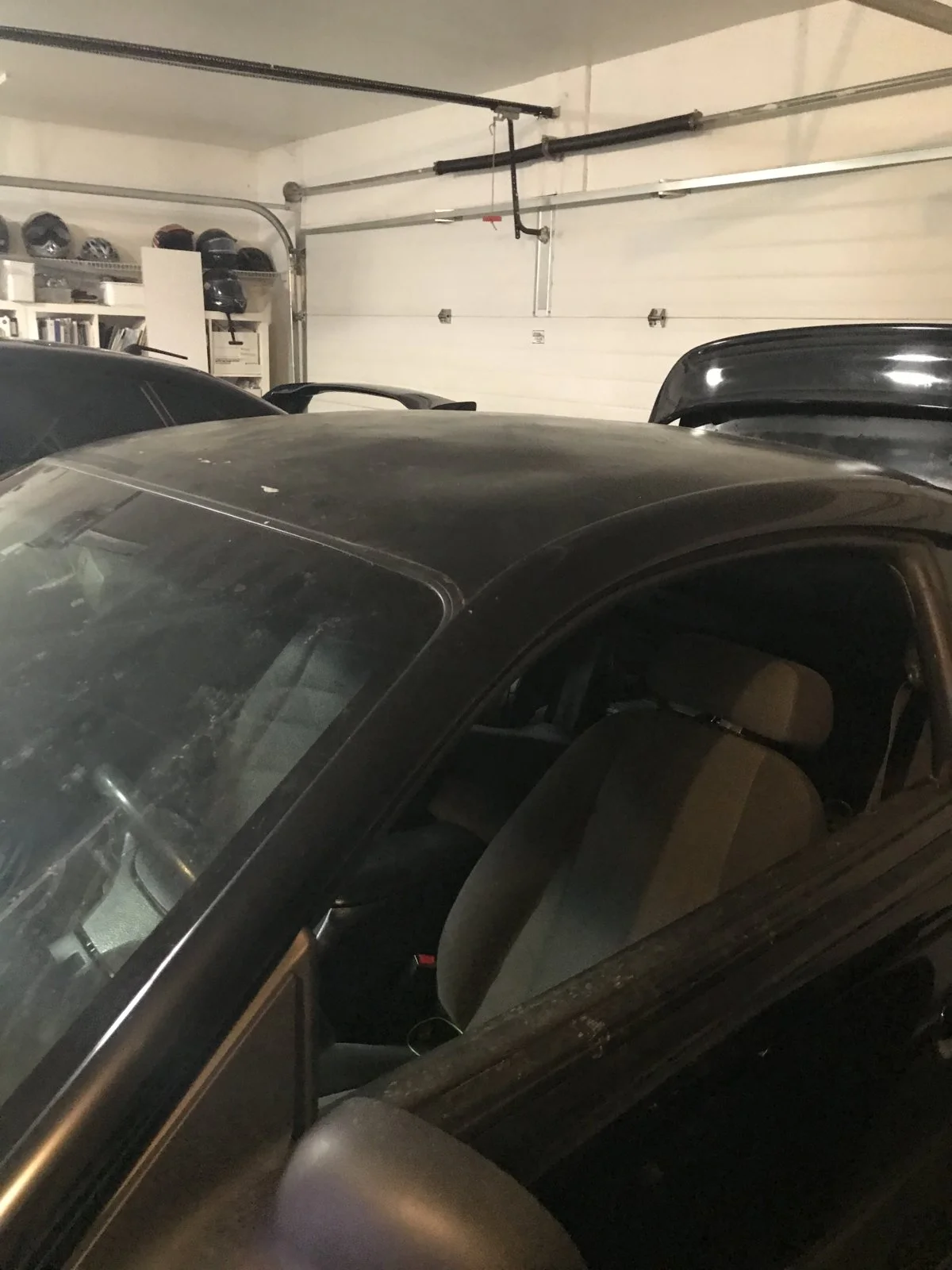

Thanks for the message John. I should’ve supplied better pictures regarding the bodywork, those are the ones I post to hide the damage :D the roof and door were damaged and poorly repaired. The good was in similar condition but I got a good condition hood from the junkyard. The plan is to change colours, something bright I’m not really one to have a murdered out car. My main appeal for rebuild is for the experience, I want to be a mechanic when I grow up so I want this car to be my learning platform. Do some interior work, exterior work and some engine work so when it’s all said and done I’ve got a cool little car to drive around and a lot more experience working with engines And cars in general.

Hi,
Have a clear pic.of where you’re going now. Question...Great career choice, your head’s screwed on tight for 16. A vocational High school with an automotive program would suit you. Any local ones? May not be too late to squeeze in. I did, Sophomore year & schedule was 1wk Academic, 1wk Shop. On Co-op & worked at a Dealership my entire Sr year.
Many Voke schools will go over the top for driven candidates to early Junior yr. transfers You’d have to dedicate yourself, 100%+, but it’s been done. Jump at that hard & fast if interested/feasible.. That being said, now the project. Have the technical manual yet?
I’ll help you in any way I can with this 4.6l build.
