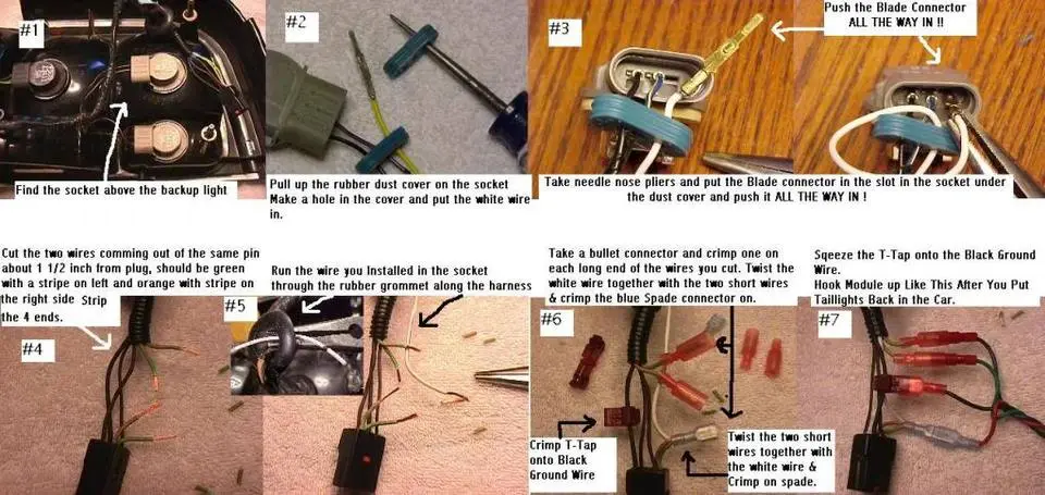

Maybe the SN-95 harness is different, but the spliced wires had to occur within the housing. The sequencer was located in the trunk, but I had to splice into a few wires between the headlight housing and the body of the car... water got in there and f**ked me.
I bought mine from Webelectricproducts.com and they have a lifetime warranty, so I can mail it to them and get new ones, but my stock wires are all corroded from getting water in there.. sucks.
I installed the kit. Literally there is one wire that goes through to the housing. and it goes inside a bulb socket just like an oem wire would and the oem rubber boot protects it.... All other connections are done inside. I soldered the connections instead of using the crimp on connectors it came prewired with...... I think it should work fine....
Look at figure 3............ the white wire is only one to go through to the tail light.
