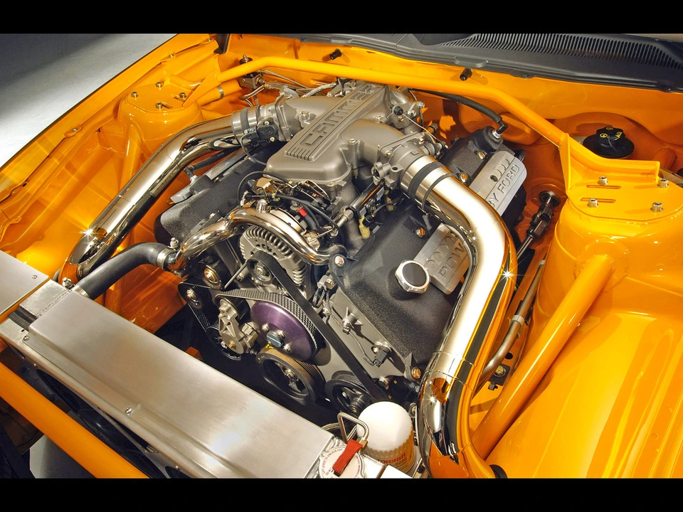

I'm not talking old 5.0, definately talking about the new stuff!!

the Cammer 5.0 mod engine is a great choice, 385bhp is stock (as used in the MG ZV supercar), with a few mods they should be good for about 450bhp. The stock CR from Ford Racing is a little high for an FI setup, but a slightly lower CR with a blower should see 550-600bhp all day long every day no porblem. If you want to run it harder then there is still more, it should have the potential to be 40-50bhp more than any DOHC 4.6 as fitted to the 03/4 Cobra's.
