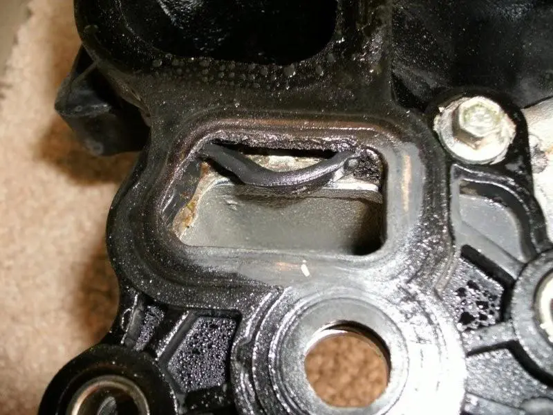

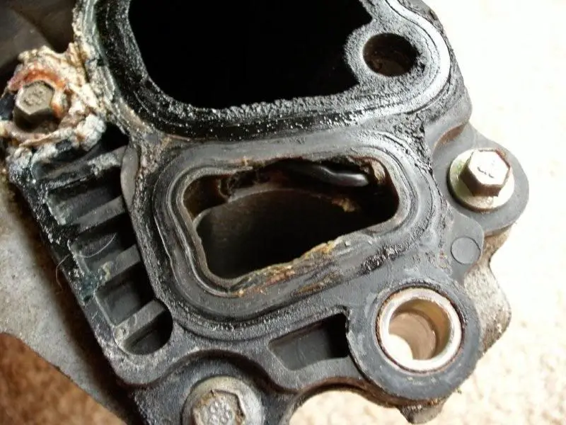

I agree with streethorse. Stop leak could plug up your coolant passages and damage your engine. With a coolant leak, I would never use the car to travel the distance you are planning on driving. You would be better off renting a car for that trip. Your coolant leak may be coming from above. My sons 2003 GT was leaking coolant in two places. One was at the base of the thermostat housing, (shown in lower picture) and at the base of the aluminum cross over channel on the passenger side (shown in upper picture). Not saying that your coolant leak is in the same location, however, if it is, you won't make it to Texas. We ended up replacing the intake manifold to correct our coolant leak problem. I would really hate to see you replace your engine from overheating problems while on your trip. Good luck. Hope this helps, Tommy.

He has a 4v cobra.... totall different animal.

Thanks for catching that squeak93. I should have seen that. In any case, the point is, if his engine is still leaking coolant, I would really advise him in fixing the leak before he takes on this trip. Good luck, Tommy.
