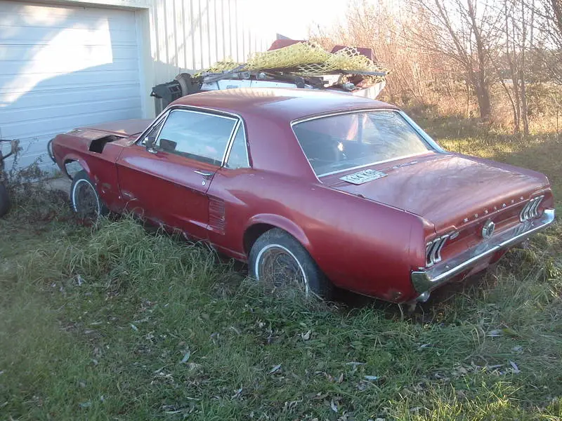

I am an experienced Honda guy, so my Ford knoledge is not as strong as it should be. I am going to look at a 1967 Mustang Coupe, and it is coming with a 289 and C4, and it also has bench seats in the front (I am told that is rare). The body is a mess, but the rest appears to be salvagable (from the picture).
Question #1: Did any V8 models come with a 4 bolt hub? Or is this car a V6 model and someone swaped in a 269? I do have a serial number converter and I will check it when I see the car, but I would like to know if any v8's came with the 4 bolt.

Heres a picture....if that helps any.

it means you need to change the entire drive train system. 4 bolt is not strong enough to hold up to a v8 and it will break. You need to get a ford 8 or 9 inch rear end for a V8. Someone did a cheap job and and put a V8 in and didnt convert it to a 5 lug system
