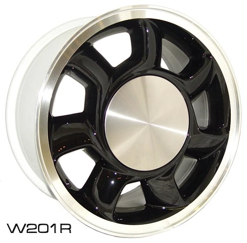

I also plan on having this car clean so i can show it too, and have my eyes set on a set of the 93 Cobra Wheels from CJ Pony Parts but don't want to get rims that i will end up taking off in a year or two to swap to 5 lug?

Something about these wheels on a black notch just make me
