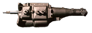

what does the srod top loader look like?
See http://www.5speeds.com/toploader.html for more information
