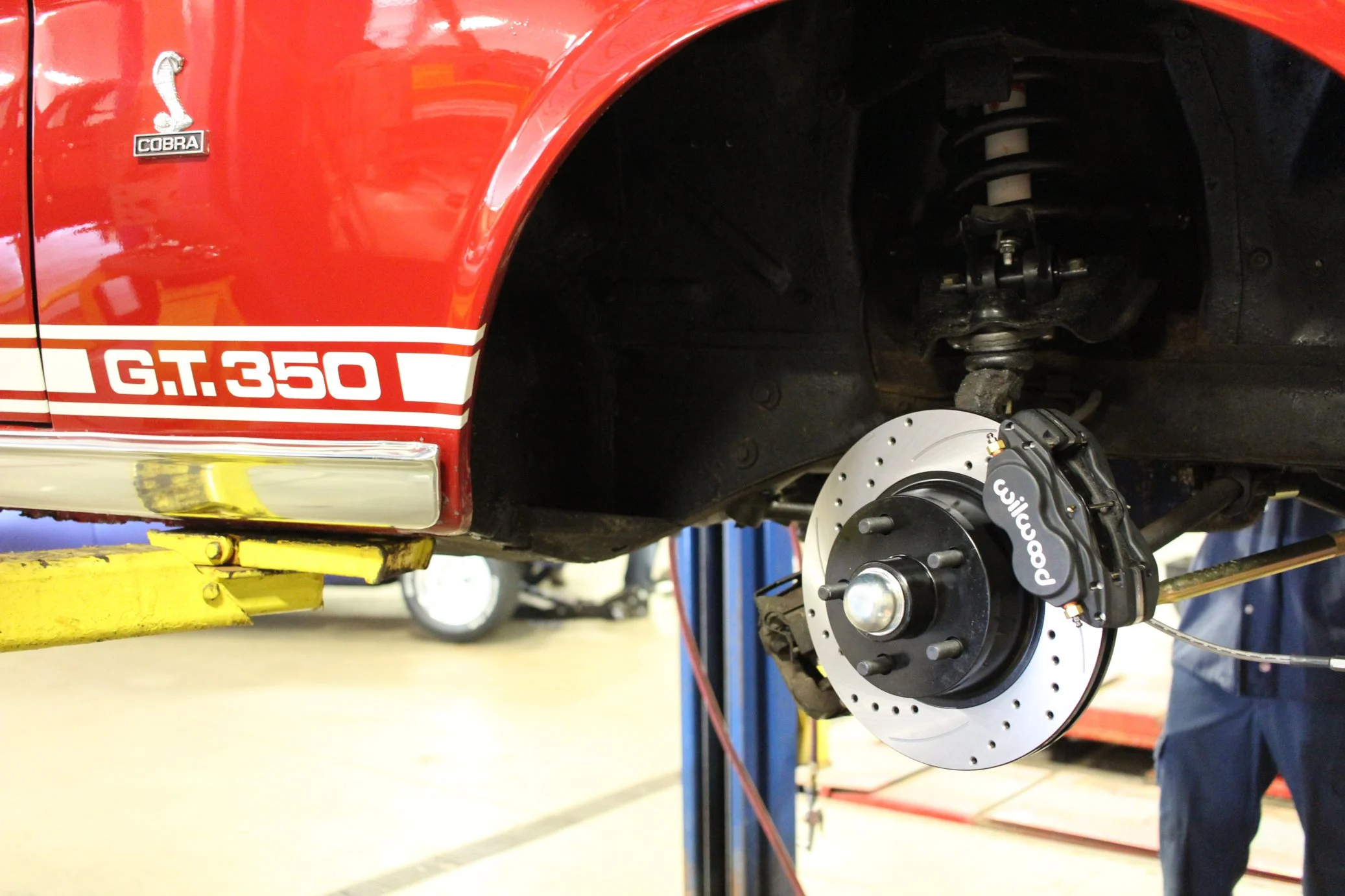

I just put one of Wilwood's new classic discs on the front of my 68 GT350. This kit fit inside the ten spoke wheels. Without hesitation I would recommend this kit. The retail cost for the full kit was about $700. I can't believe how well these brakes work. I left the drums on the rear for the time being but the Wilwood rear kit is about the same cost as the front kit. I did learn that you can assume ALL these kits including the Wilwood are designed to fit drum spindles. We had to drill and tap my disc brake spindles to install the caliper bracket. The shop that did my work was doing a SBC front conversion on a 66 2+2 drum car. Said the SBC kit had a lot of issues like things lining up properly.
Another thing I learned is that most of those kits like the SBC are copied from the original Kelsey Hayes discs that were stock when our cars were new. And like I said they are made to fit drum brake spindles.
Once my car's spindles were tapped my Wilwoods went together like you'd expect. These are GREAT brakes. I also replaced the power booster and master cylinder. Brakes are one place I would not go cheap. By the way, one of my big concerns was whether this kit or any kit would fit my 15" ten spoke rims. NO one would promise that. I talked to all the vendors I could find. And all of them said if the discs were installed on the car they would not take them back. This Wilwood kit fits a 14" wheel. I got them from CJ Pony cheaper than what Wilwood was asking for the same kit. And CJ said as long as I didn't put them on the car, CJ would take them back. CJ had them in stock and to me in a couple of days. My Porterfield rear shoes took an extra week to get to me. I am happy to say I have really great brakes on my car now. The whole project including labor, the booster & Master cylinder and Porterfield shoes ran me about $2,000. Worth every penny.
Img_0165-M.webp You're welcome. Does your 69 have discs on the front now? Discs on the rear are a nice luxury but not necessary for a street car. The majority of the work is done by the front brakes. I went with a Porterfield racing type shoe on the back. You would love my new brakes. I do. It stops very well and right now. So much better than the stock setup even before my power booster went out. I wouldn't hesitate to recommend Wilwood plus they look cool. The non slotted and drilled rotors are cheaper than the slotted & drilled rotors. There is no need to get slotted or drilled rotors on a street car other than looks. If you get a new Mustang GT and have Shelby American turn it into a new Shelby Mustang, they put 6 piston Wilwoods on it. That was enough for me. Plus the shop that did my work really recommended Wilwood over all the others. CJ Pony had the best price on the Wilwoods, even a bit cheaper than Wilwood direct.
By the way feel free to ask me questions on this whole project. I dug into it to make the decision. Learned a lot about Mustang brakes and kits available. My shop did not speak real highly about putting that SBC front disc brake kit on that 66 2+2. My car was in and out and that Mustang was still there. The parts did not bolt together well. They were going to have to modify the kit to get it to fit and to assemble it. And the SBC setup was more expensive than these Wilwood's.
