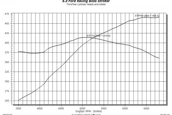

Here is the Boss 5.0 with Stroker for 5.3l Engine (Engine Dyno) , 11.5 to 1 CR with stock TFS R 195s, Track Max Stage 2 camshafts .580-inch lift and 234° duration @.050 inch, strong mid- to top-end power and a 1,800-6,500 rpm powerband, dual 70mm TB with TFS Track Heat Intake, 36 lb injectors, and 1 3/4 in longtubes.... This engine dyno produced 466/414 which would be 396.1/351.9 RWHP to the tires through and Auto with est 15% drivetrain loss or 410.08/364.32rwhp though a manual with 12% Drivetrain loss... keep in mind, the TFS Track Heat is really designed for upper HP and trades off in TQ....

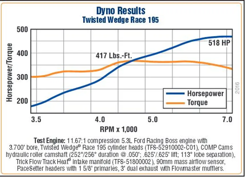

Here is the Test run and only difference noted was a custom grind cam that went to a .625/.625 lift with more duration, same intake, but looks like different size headders with 1 5/8... and 11.66 to 1 CR....
This engine dyno produced 518/417 which would be 440.3/354.45 RWHP to the tires through and Auto with est 15% drivetrain loss or 455.84/366/96rwhp though a manual with 12% Drivetrain loss... same thing with trade off with HP and TQ with the higher reving intake...
Considering cam profiles used and neither setup had ported heads there was potentially 25-50 more HP/tq to be gained on either of those set ups from 3k to 6200 for peaks if not more.... looking at a normal Bullet intake chart on page 5, the TQ was really impressive and to compensate for 12-15% drivetrain loss, the 5.3l combo with normal intakes on stock 185 heads with 11.3cr put down 393/398 this would translate to 440.16/445.76 with 12% or 451.95/457.7 hp on the dyno... and that is with stock 185s... so ported 185s, stock 195Rs or ported Rs, along with higher lift cams, you can get over 400 to 450 hp based on set up easily...and build peak Power and TQ in the daily driver range between 5500 to 6200 rpms.... good stuff...

One final thought about 500hp at crank... as seen in the TFS test engine with 5.3l using r heads and their high flow intake.... pretty easy to hit with expanded lifts from .575 to .625...this puts rwhp around 455hp and 360tq to the tires.....
As show with the dyno graph with 5.3l 38cc stock TFS HEADS and .575 lift cams with 393rwhp and 398rwtq this would be about 440/445 at the flywheel....

Also, one last thing...lookin at the TFS build with 5.3l, TFS R heads, and .625 lift cams.....stock R heads flow around 270cfm 199 ex..... I have seen R heads ported flow 292 in and 219 ex.. .at .600 lift and was still picking up flow.
..they should have tested to .650 lift which would have been around 305 to 310 cfm and 225 to 230 ex at .650..... so in theory the car put down 518/417 on the dyno With .625 lift...which equates to 455hp and 366tq to tire... with mild port shown above with using math on head flows...the 30cfm gain a5 .650 lift would equate to 60 to 65 more hp at the crank... or 580ish crank and 477ish tq....which would be around 510 hp and 422tq to the tires on a manual with 12% drive train loss... max effort build...could aways get a bit more with 12 to 12.5 to 1 cr and E85 tune....so still a lot of potential with a full out build..with bump in cr and e85 about 3 to 4% more hp or 25 more hp and tq for hax build...potential is there...
