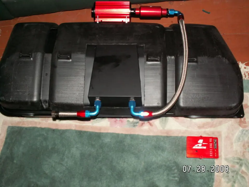

I say Build it yourself. I noticed the kit doesnt include everything Aeromotive says you would need (like a second filter). Also i cant justify $500 on a gas tank. I bought a new replacement gas tank...drilled holes in the rear and had a sump welded on. Paid $90 for the tank and $35 for the sump with AN-10 fittings.
Either way with that much displacement making that much power....you will need to upgrade the fuel system.
Below is my fabbed up Sump system. After i primed and painted it flat black with engine paint.

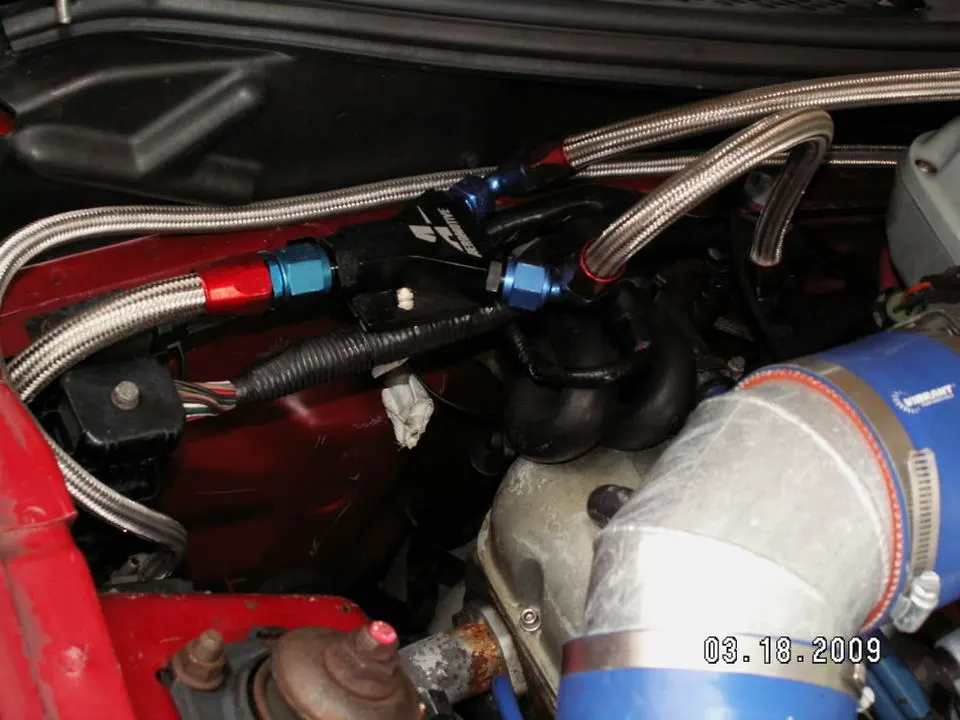

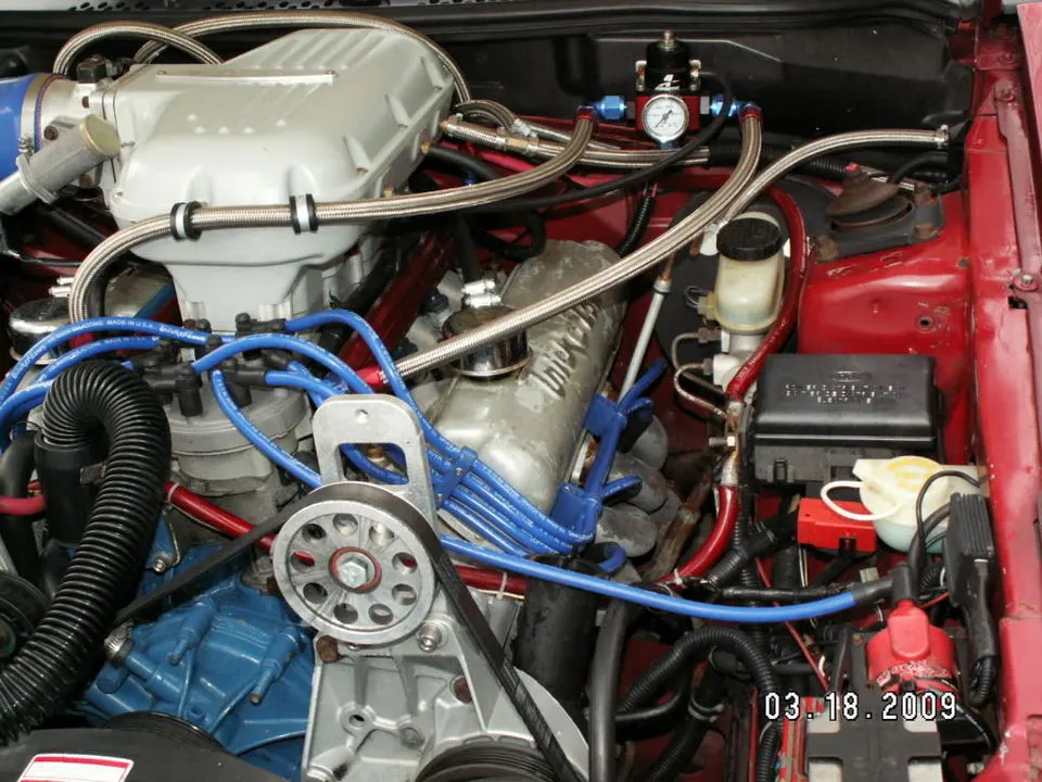

A year later and still no issues. To save cash i used the factory fuel feed line as a return line.
Another thing is Aeromotive wants you to connect each rail to each side of the regulator. Some of these kits have you cap off one rail and balance off fuel between rails in the Y fitting. and the return is on one rail. I don't like it that way personally. So thats not how its set up in my pics.
