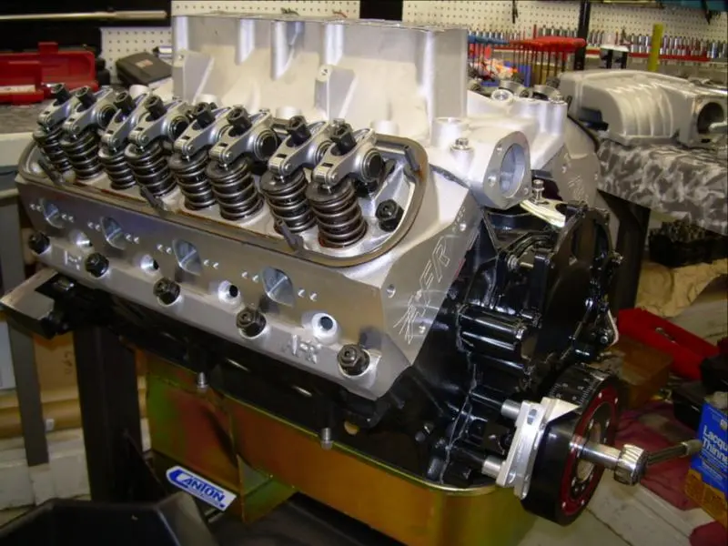

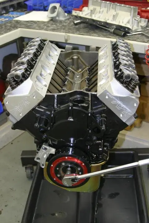

now for the pics ...
they are all here ... http://thecurls.net/Stang95/pics/408-build/shortblock/all.html

i think that edelbrock intake might be a little restrictive for that many cubes.:shrug:
what if u went with the performer rpm II or maybe even a boxed upper? it looks like those guys know their sh-t. where did u get the 351 block?

BTW isn't that the wrong timing chain cover? That looks like a pre-93 cover. Whats up with that?
Danny
when i called march and was deciding on the accessory brackets, they told me to get an 87-93 one, so i went to summit and ordered one. that is what came ... :shrug:
i noticed to that it has the fuel pump opening; my builder blocked it off.
i actually asked him about it today while i was looking at it at lunchtime, and he said it would be fine, but he says this one is not as easy to use because it doesn't have the "positive alignment" dowel things so it is harder to align it when installing it. he said that he is not worried about it, and believe me, he would not use it if he wasn't sure it would be ok.

Oh ok. I didn't realize you were going to go to the older style brackets. So you getting rid of the a/c and stuff? Just keep Alt? I guess i'm just curious. BTW another issue if you dont set the engine back your going to have clearance problems with the water pump and electric fan (pending your still running the stock style one. BTW I'm guessing I haven't followed your build to closly. But it looks good and will definatly run good.

i got a AJE k-member that drops the mounts down 1/2" and also is set up so i can move the engine back an inch. those 2 things together should help keep it under the hood too ...
cool... I can't wait to see how your going to mount the accessories. I could be wrong I was always under the understanding to mount a a/c on the march setup you had to run a pre 93 style a/c compressor.

i saw it again today ... the guy is putting the accessories on. those march brackets are beautiful, but the heads have 7/8" accessory holes and the march brackets are set up for 3/8" :bang: he is deciding if he is going to helicoil them or drill out the brackets. i think helicoil is prolly the best route
