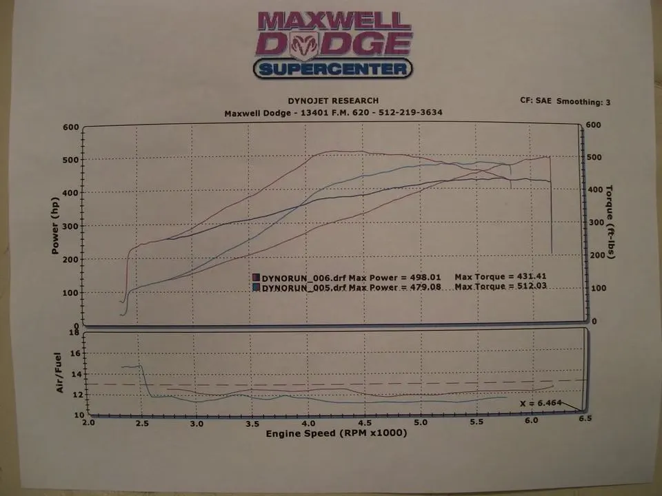

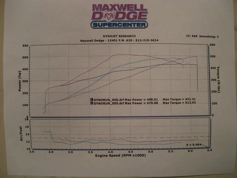

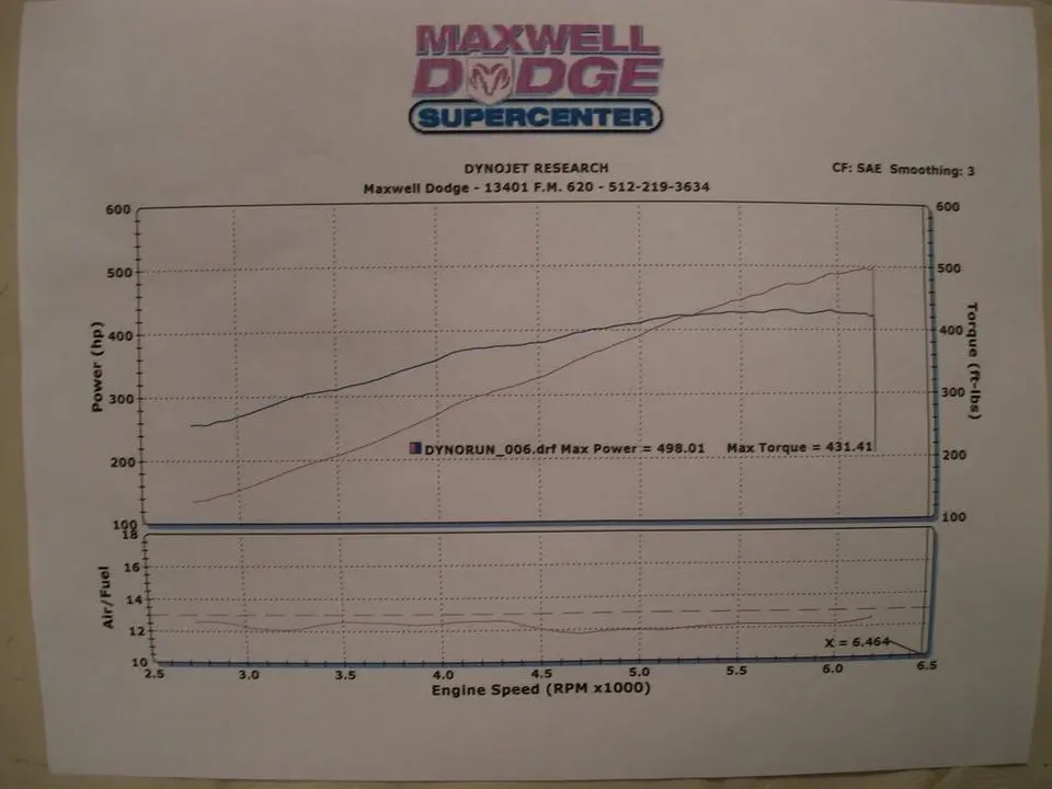

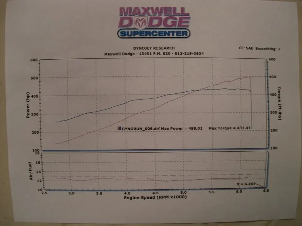

Stock shortblock 2V with N/A cams :nice:
And overlayed vs my 57s @ 9.2PSI
So I learned 3 things.
A. I need to put the 3.27s back in!
B. I need to upgrade my fuel system!
C. I need a retune!
Basically I was seeing 8.5PSI @ 6050ish on the second pull (not listed) where it put down 489RWHP (due to not revving it out to 6200). I didnt watch the boost gauge on the first pull so I would say MAYBE 8.6-8.7PSI. The dyno just wasnt loading the car down and it was building boost with RPM. I see 9.6PSI on the street @ 5500....so that means iv been running it at a good 13-1+ A/F on the big end :rlaugh: . If it would have got full boost, she would have made over 530RWHP :eek: .
I never even heard a PEEP out of the turbos....just no load there with the 3.73 gears and low load of a dyno jet. :(
BTW if anyone is wondering, we just put on twin T-61s. So thats teh only difference. Ill have pics up shortly.

its the PSI these motors cannot handle. with larger turbo's, you move more air at lower boost levels than smaller ones. this is why properly choosing turbos based on goals/setups is key, as in the above. with a mere 8psi hes making close to 500whp. i know for a fact most guys run 11-12psi on intercooled vortech or procharger setups and make barely 450 to the wheels while at that level, running their motors on borrowed time.
IMO even at 10psi with a great tune, youll still put down 100whp more than any centrifugal guy and put less strain on the rotating assembly.
