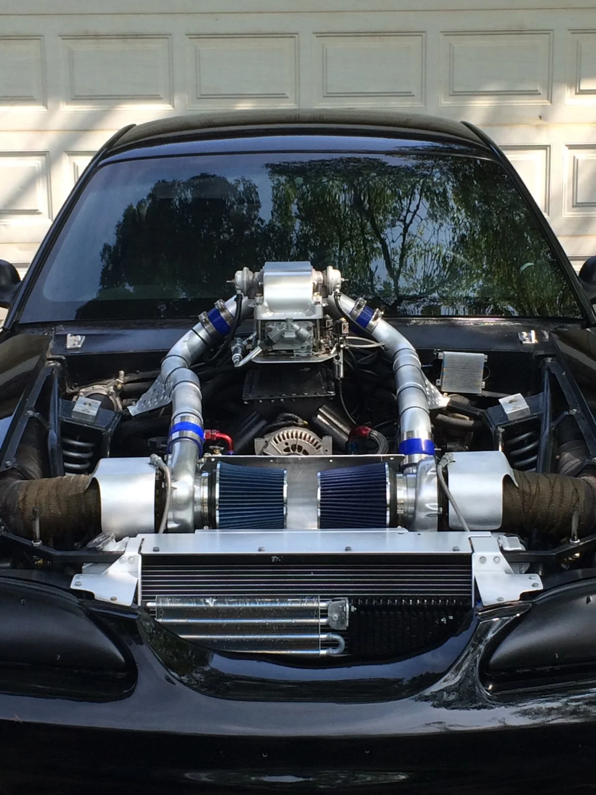

has anybody used the transgo full manual control kit for there 4r70w with any luck? its a 96 4.6 with twin turbo IMG_0990.webp IMG_0979.webp

Well might I suggest you install one, post up the process and give us your opinion.
Oh, and tell us more about the twin hair dryers and that mod monster!

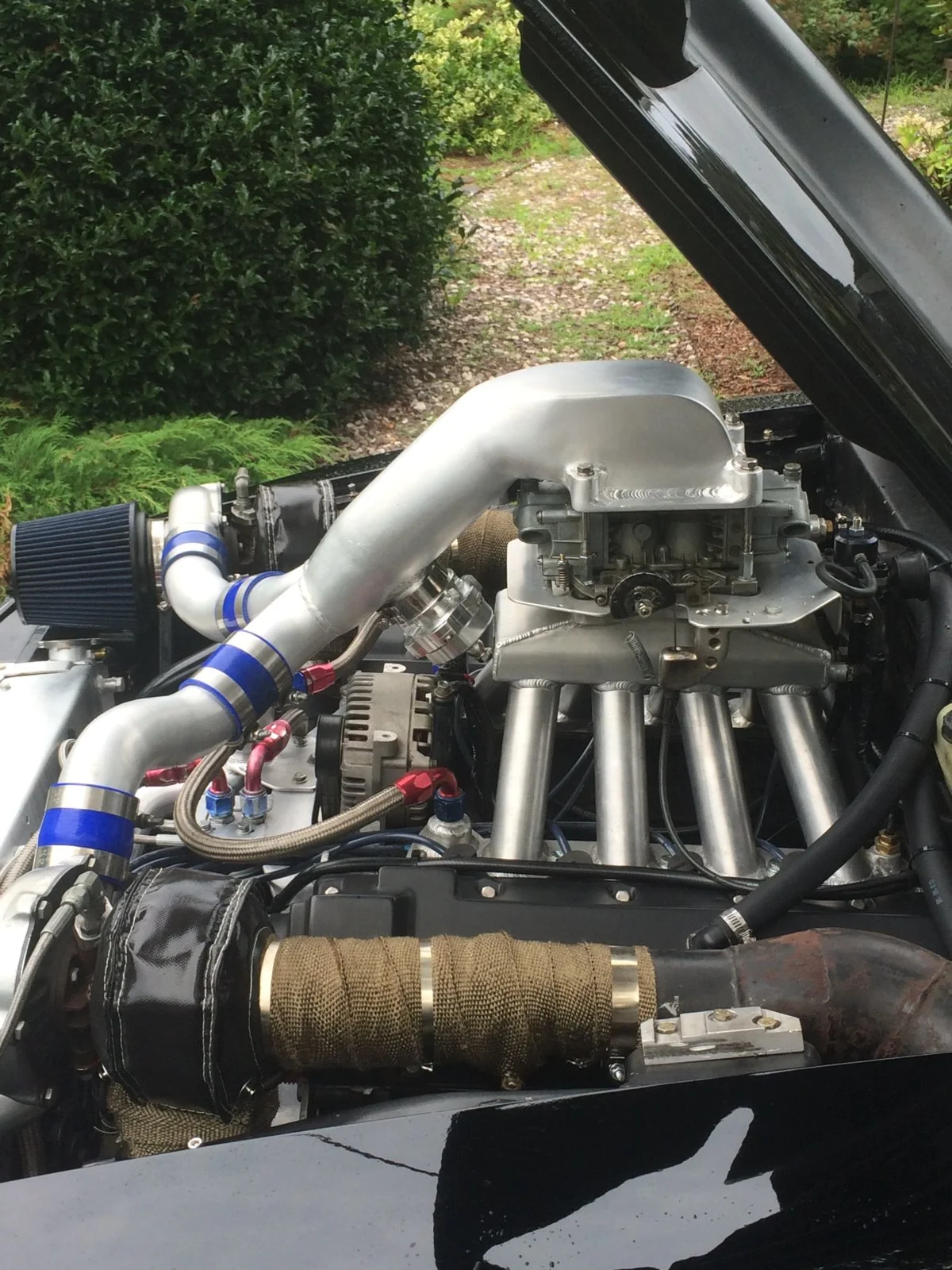

Did you build that crazy intake yourself? Love it! Tell us more! :nice:
I put the engine together about 3 years ago. It has eagle stroker kit 302 ci pi heads ported crower springs and valves custom ground cams that were for a vortech v2 with bullitt intake. that setup made 540 at rear wheel with 4r70w and 4.10 gears. I got bored during the winter and it ended up twin turbo with new intake and a 4150 holley blow thru and rebuilt trans and new converter. That lasted the next summer and winter came back and engine got changed again to what it is now it does have manual valve body now. never had any engine problems and I beat the crap out of it every time I drive it vortech I ran 12 psi now with turbos its around 18 psi. I made the intake distributor setup headers engine plate pretty much every thing.
