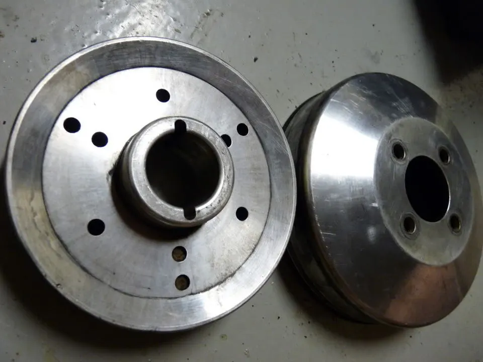

I pulled a set of underdrive pulleys from a 93 or 94 Lincoln Mark VIII with the 4v 4.6. The set consists of a smaller crank pulley and a larger waterpump pulley. The size difference is very noticable compared to stock. However, I can't find any name brand or markings on these pulleys. They look to be nice pices of aluminum though.
So can I bolt these onto my 97 GT 2v? The crank pulley looked to have 2 keyways, for whatever reason. Does the crank pulley act as a balancer? Also, do you typically need a different length belt for underdrive pulleys?

yes, you should be able to use them, the crank pulley is not a harmonic balancer...all 4.6L are internally balanced, however it does act as a harmonic damper...according to what I have read anyway....and in my experience belt size will be different...but it doesnt hurt to try your old belts first

Thanks for the reply. One more question... Are these pulleys meant to be used as piggy backs? The car I pulled them from didn't use them as a piggy backs, but the crank pulley doesn't seem to have enough weight to be a damper at all.
