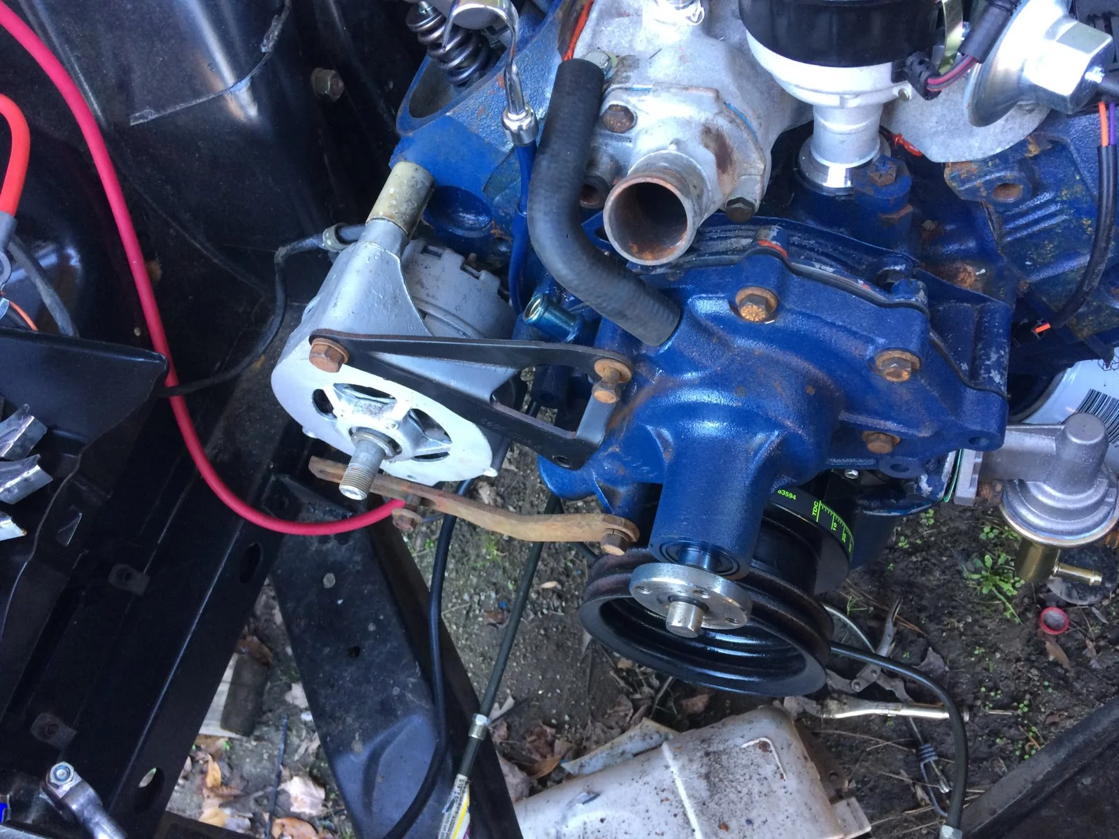

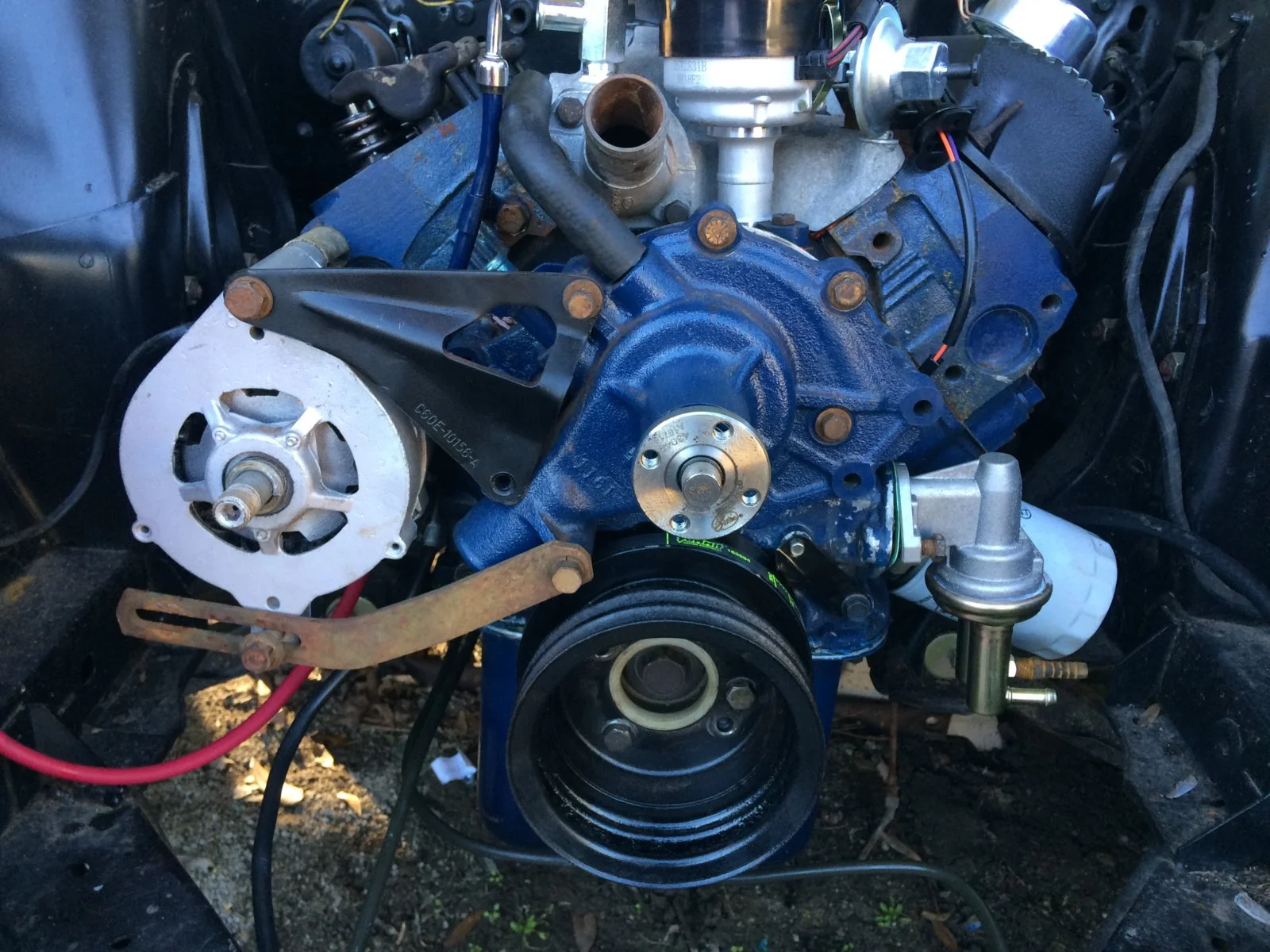

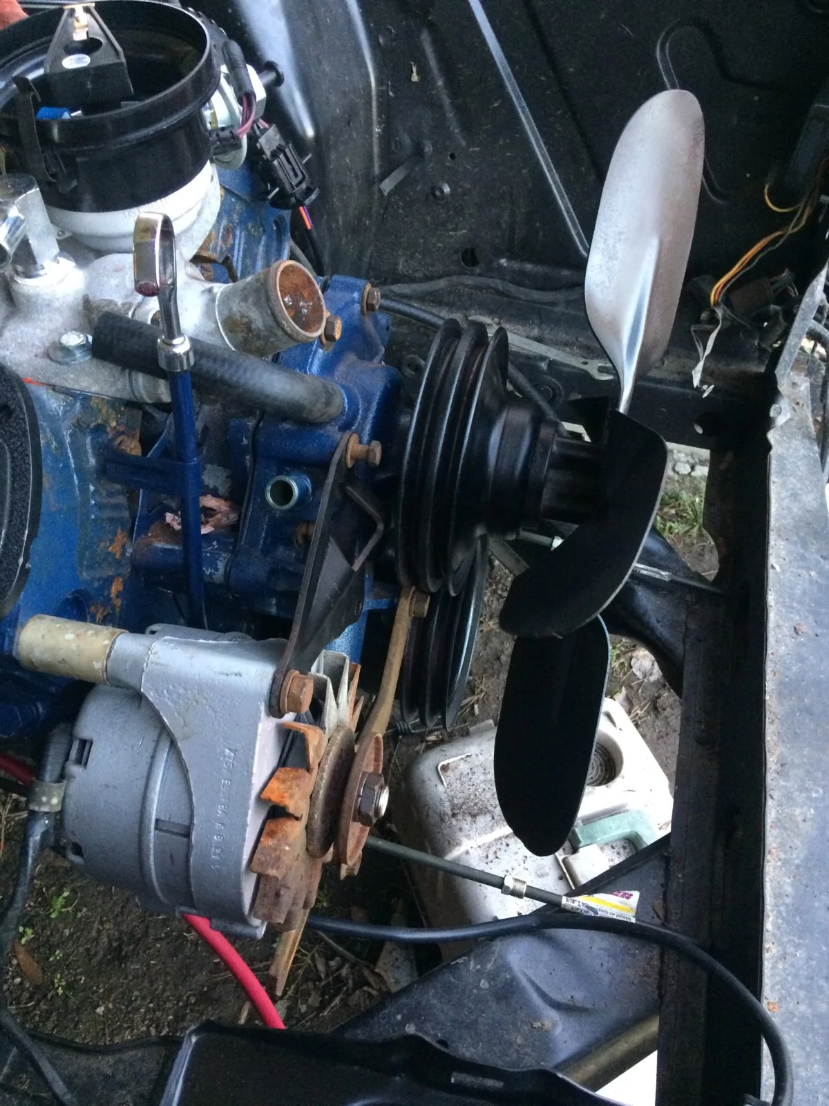

Here’s pics of what I have. I think I am gonna finally be successful at having a fan belt

All the bolts weren’t in. I just stuck it together to show what I’m using. The alt wires don’t hit the back of the head. There’s a spacer between the head and the alternator that keeps that from happening. I’m not worried about switching to serpentine pulleys because I all I’m running is an alternator.
