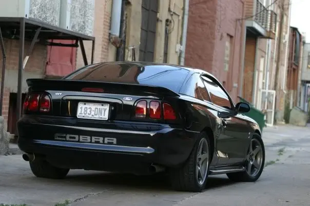

Hey guys, I had a question I was hoping you guys could answer. I have a 96 gt, but have recently been looking at a cobra, specifically a 94 or 95. I think when done right, it is the best looking Mustang. My question is, how good and reliable is the old 302 motor? Are there any common issues with these year mustang? Such as intake manifold like in the 4.6. How well do these cars handle boost? Or is building the motor such as heads, pistons and intake enough? I'm looking for about 300 hp rw. What would that take and a rough estimate. Any information would be appreciated. I have attached a picture of what I'm looking for a finished product. Thank you.

The car in the picture has '96-'98 tail lights and bumper cover, and some sort of aftermarket spoiler with what look like '03/'04 Terminator wheels.
'94/'95 Cobras used the V6 bumper which says "Mustang" and they have the horizontal tail lights.

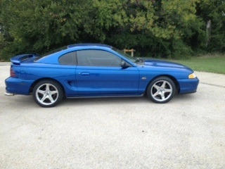

Agreed, if you're looking to tear the motor apart and do your own custom build, a GT would be a cheaper car to start with. Of course, having those snakes on the fender and the other Cobra parts are just as nice. :) Now, if you want to just put a supercharger on the engine and be done with it, you'll tend to get more power out of a Cobra engine. All depends on what you're looking to do.
