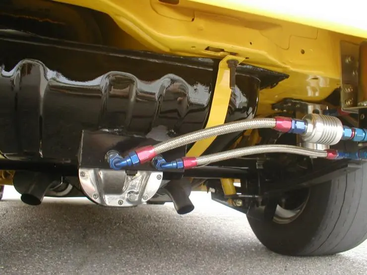

77CobraII said:
Like this?? :D
Ya ! :D
I know i seen pics before - i think it's your car i've been thinking about..
So how long did it take you to do the swap /?
run across many problems ? trans or rear end .. Wireing ?
Was your M-II org. a v-8 -4-speed ?
Well what do you think was the hardest part in the swap ?
