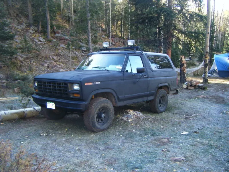

ummm this isnt a car. its A FORD BRONCO 4x4 i need low end torque and hp for offroading and towing, and there wont be any money in the heads. a very good friend of mine is well known in the corvette world and he is porting my heads for free n exchange for some of my work, so why not do it if its free right?
just so everyone is tracking this is the vehicle getting the 5.0HO
