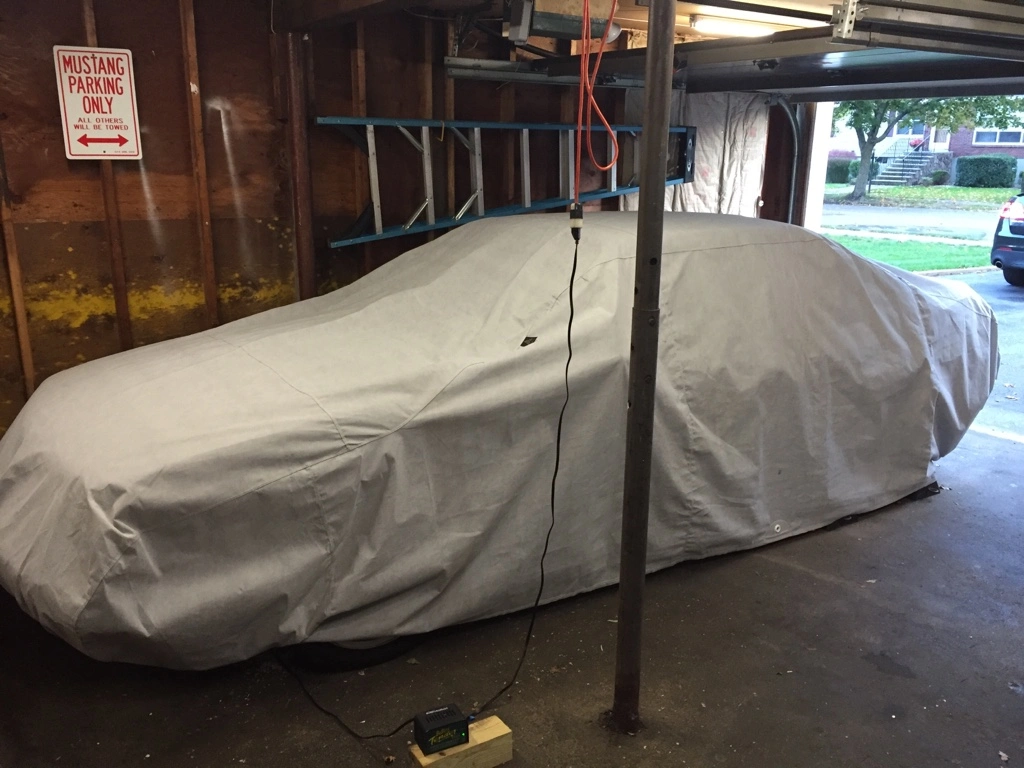

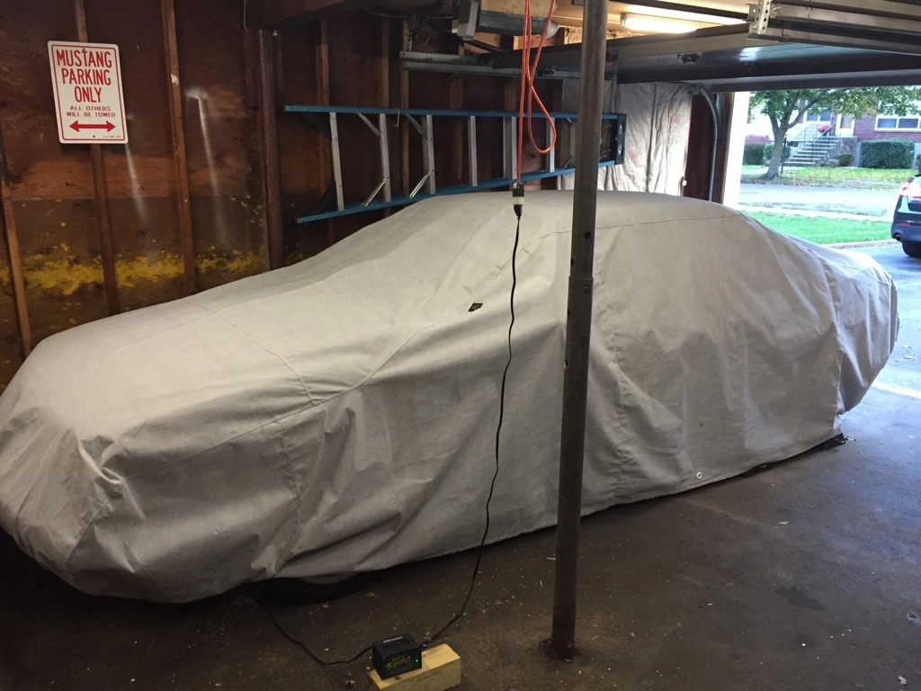

Weather tech makes really good car covers. I have a Corvette buddy that stores his under a cover in the garage,but it sits in the driveway on occasion for a few days,under the cover- and it does a good job.
When I put mine up for winter (which it's been put up for a year now lol) I put 8-gallons of gas in it with a bottle of STA Bil fuel treatment. Checked my antifreeze and topped it off. Disconnected my battery and put it on the battery tender and set my tire psi about 5lbs more than normal

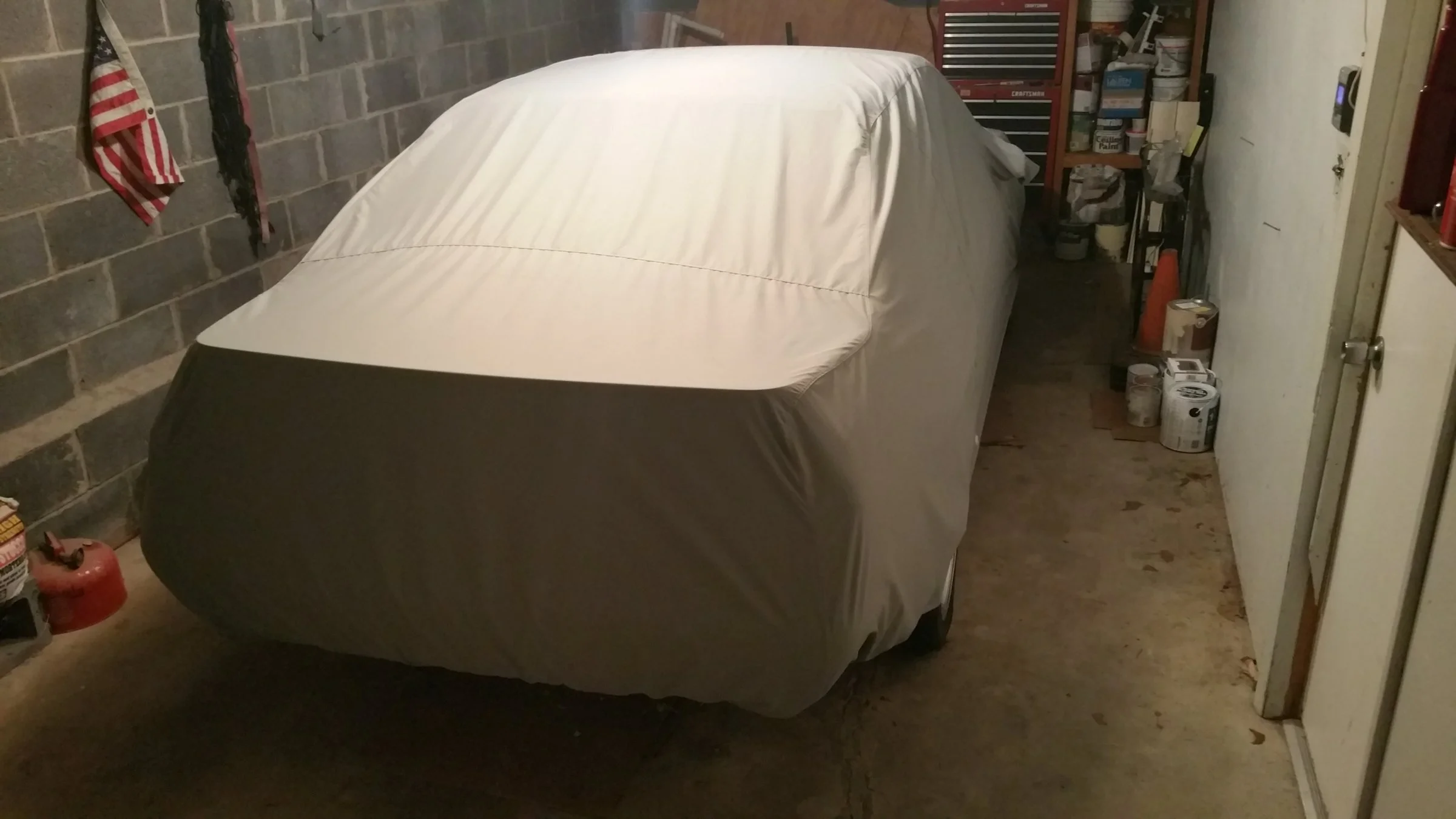

While I like fitted covers, I ended use getting a standard one just for keeping dust off inside the garage. I believe I got it from American muscle.
As for winter storage? Change oil, and that's about it. I'll prob still bsck it out of the garage when it warms up to 35 in the middle of January and I'm bored.
I need the car mobile because this winter I need to finish the garage. Electrical, insulation, Sheetrock and paint. Tired of looking at studs
