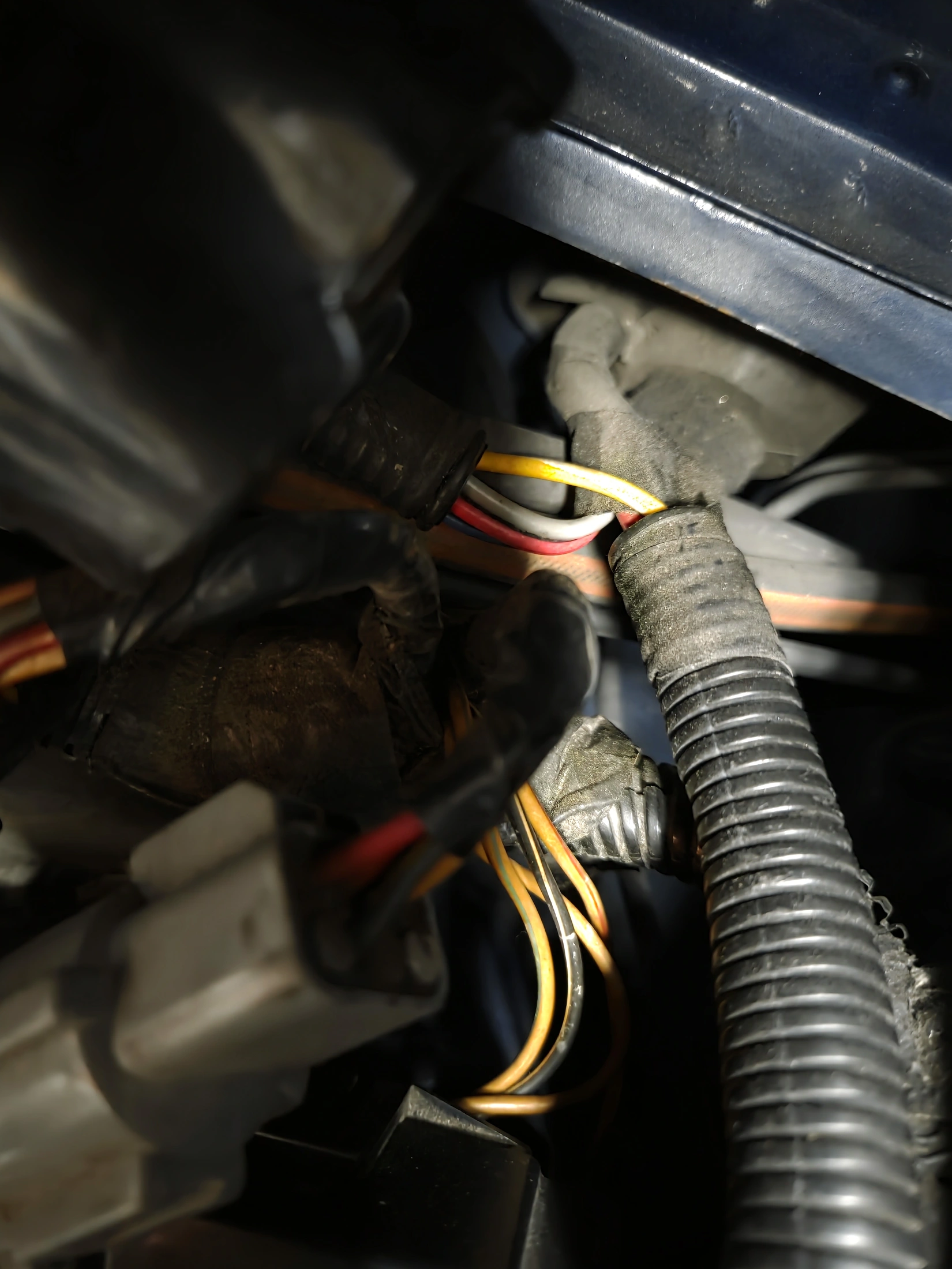

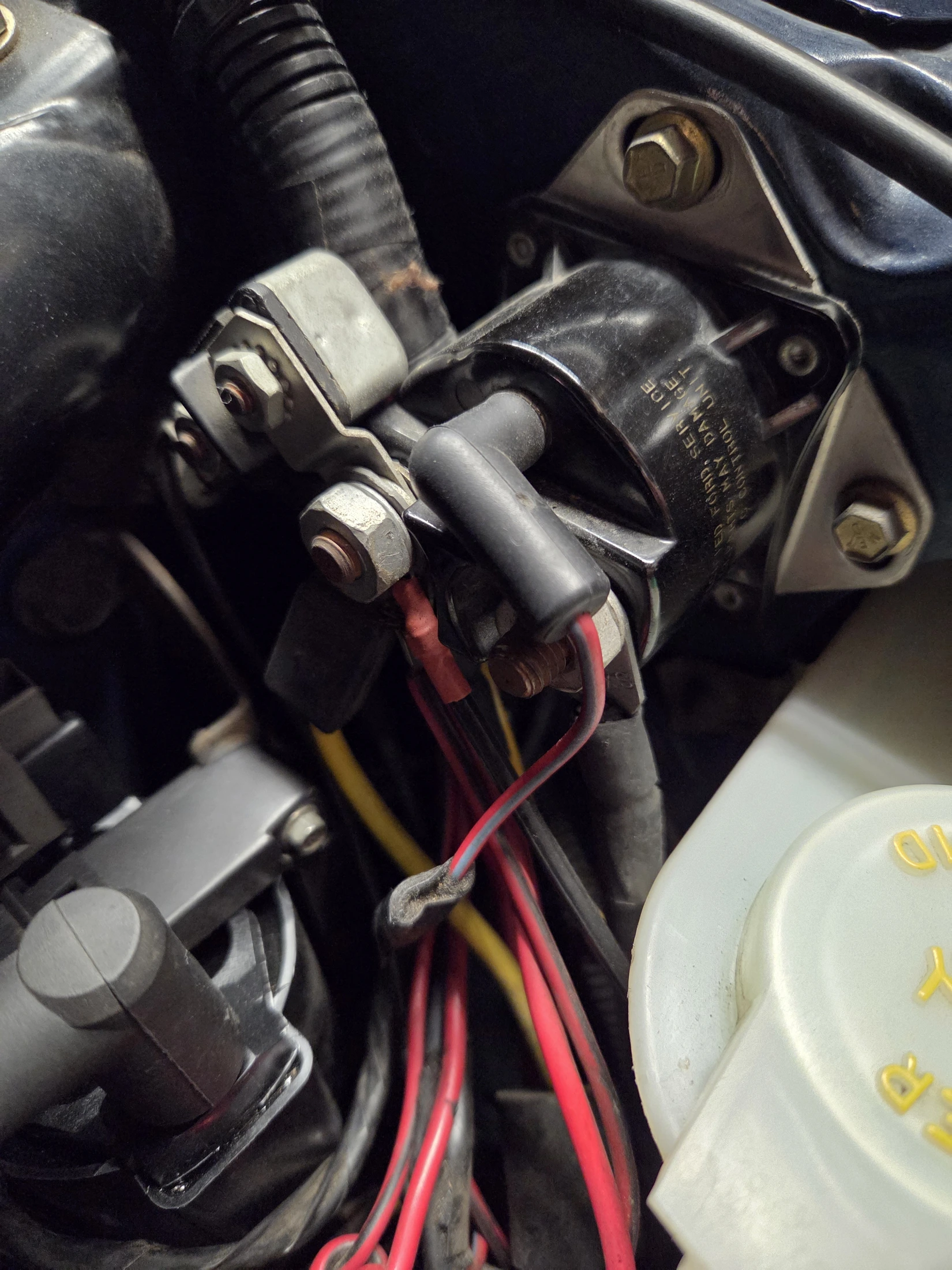

If you want to install a kill switch regardless of how you store it. On the starter solenoid cut/break the red with blue strip wire. I only solider connections like that vs crimp connectors (see pic) and connect it to a toggle switch hidden in the drivers compartment. I would use 12 or 14 gauge wire as you're extending the run of the circuit. A single pole toggle with a 20amp rating for 120v will be fine (Home Depot) has them. Most people put it right under the dash, but most thieves will run their hand looking for something, so find a good spot. I also put the wires in the black plastic loom and use black wire ties to tie it with the factory loom. The rubber boot coming from the firewall next to the fuse block is a good place to enter the inside. (see pic) This is how I did it back in the day when I used to install alarms and such in the "70s and '80's before all the electronic stuff came out. Just my 2 cents.
