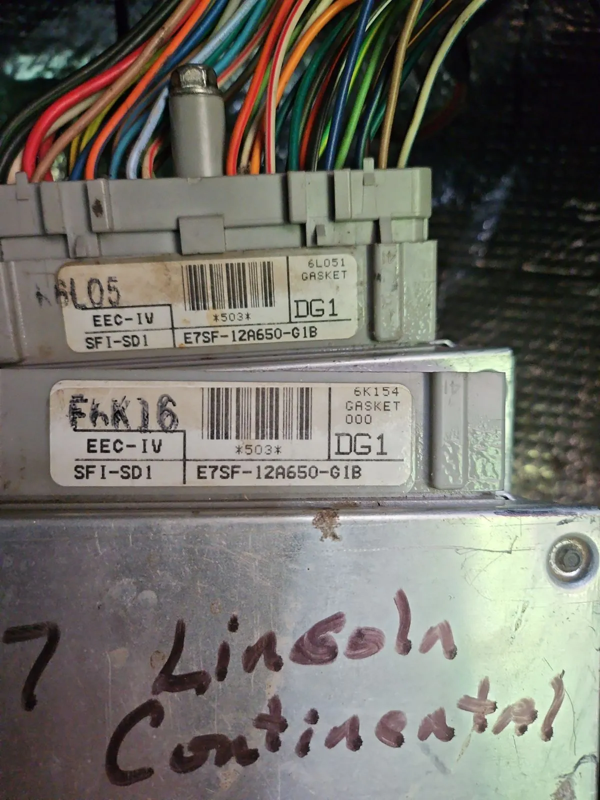

A picture of the label will help. Like this.
Reason I ask is because there are sorts of ECU/wiring harness/Injector mismatches that occurred within the EEC-IV run and not having the right component pairing can cause issues.

Here is a pic of the ecu's. the one in the foreground is the original ECu and the one in the background is the one we are running now. We are in the process of pulling the codes now and will post them as soon as we get them. I did not wire up a CEL so having to do it with a test light.

DG1 is an '87 T-bird/cougar ECU. E7SF = 1987 thunderbird engineering part number. Did you source this ECU from the same donor vehicle?
WHat has me curious is this ECU says "SFI-SD1" which stands for "sequential fuel injection - Speed Density 1". This differs from batch-fire which is denoted by "EFI-SD#" on a label.
I'm wondering if you have a batch-fire vs sequential mismatch. Need to do a little digging however. But did the ECU, wiring harness and engine all come from the same '87 conti?
EDIT: Nevermind, i found a source that states that ECU is compatible with the '87 continental. So that likely rules this avenue out. Still doesn't rule out that the ECU is bad? Pretty much we assume any ECU from that era has leaking capacitors and should be checked. You can open it up and inspect it yourself.
