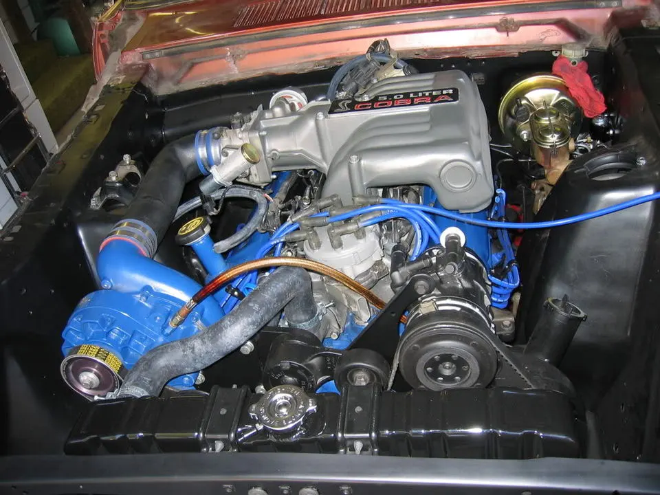

for the upper hose try an upper hose from an 80's 5.0 mustang. That's what I used on my '66 granted I have an aftermarket radiator. Here's a pic of my 5.0 Radiator hose.
attachment.php
The stock upper hose for a 5.0 Fox Mustang should work. For the lower hose, you should do one of two things.

For the lower hose, you can use a LOWER rad hose for a 1971 Maverick 302, NAPA #NBH 7470, Gates # 20702. This fits really nice when the radiator has a drivers side outlet.
Another possibility for an upper hose, if things get in the way (like a supercharger), is to use a LOWER rad hose for a 1986-1990 Bronco II 2.9L manual trans, NAPA #NBH 8427, Gates # 21736
(Please excuse the nasty looking oil line to the s/c)
