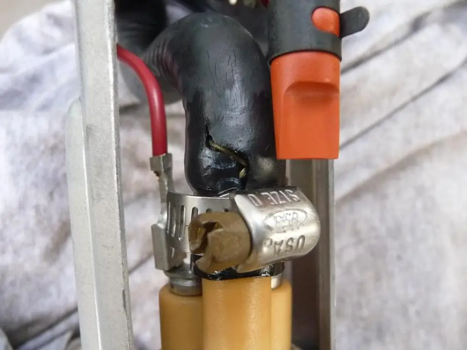

Make sure you didn't kink the return line. It runs pretty close to the suspension components on the passenger side front. I did it to mine before. The return line was laying on top of the tie rod end / rack assembly rather than looping along side it. It caused a kink that choked the return line completely. That caused the rubber line in the tank to burst and at that point, pressure would never build and the pump would just run on and on.
When I say the hose in the tank burst, I mean this one. Its the one where the fuel pump hooks to the sending unit in the tank. The kinked return line in my case contributed to excessive pressure and blew this worn hose. After that, pressure remained low and pump would run on.
