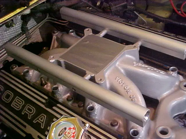

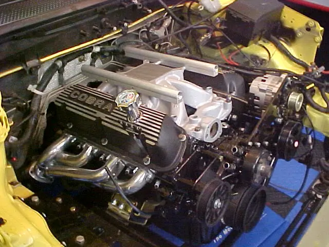

Who out there knows of a company turning the victor jr. intake into an efi set up? Edelbrock offers a super victor efi set up, but does not appear to have a jr.(in the spider style) for it. The super has a bit too large of runners than I would like. Let me know what you have found.
i had mine custom made- they dont sell the vic jr with efi
The engine is in a 2001 zx3 focus 3 door hatchback, Im converting it to rear wheel drive/ 5 speed.. I am going to use a custom Reichard Racing plenum, still have to fab the throttle linkage, etc.. project is still underway
Thanks, Dan
