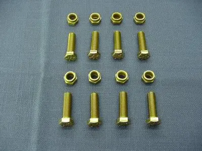

I believe 8 of these bolts and this bolt kit will work, am I right? They are a lot cheaper than Ford dealer or 50resto sells for.

The bolts look like these.
Breeze's description - OEM Ford 12mm flanged caliper bolt to attach calipers to SN-95 front spindles and IRS knuckles. 2 requried per caliper to spindle.
These will work for mounting the rear calipers to the bracket plate, correct?
You'll need this kit if you have purchased a new Ford Racing 8.8" solid axle. Includes 8 each Grade 8 bolts and grade L9 all metal locknuts.
Sounds right, but wasn't sure as I'm not installing a new 'Ford Racing' axle.
Thought of something else. The clips to hold the M2809A ebrake cables to the calipers, anyone know if they are identical to the clips used on a 94-04?
Yes, the clips are the same...just simple E-clips. I got some at home depot but ford will have them too. Make sure you get the bracket that holds the cable away from the tire as well...comes on any 94+ Sn95
the banjo bolts may be 10mm, it's been some time since i've had to buy some.
The caliper bolts are the same front and rear, so if the kit says it works up front, it will work out back too
