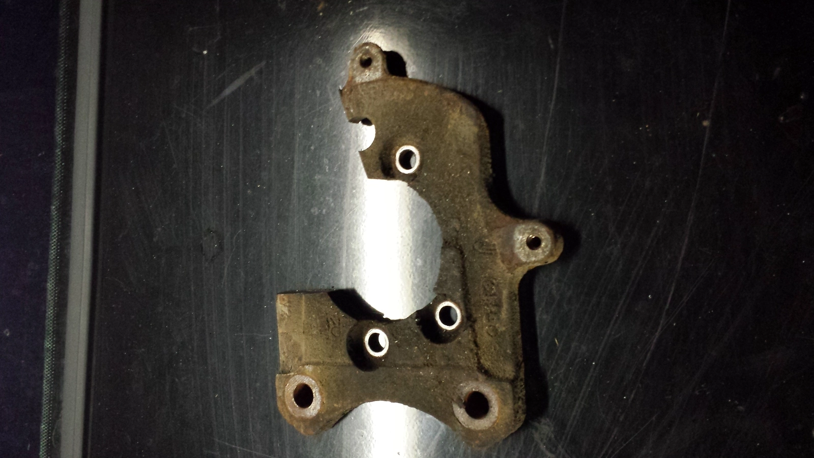

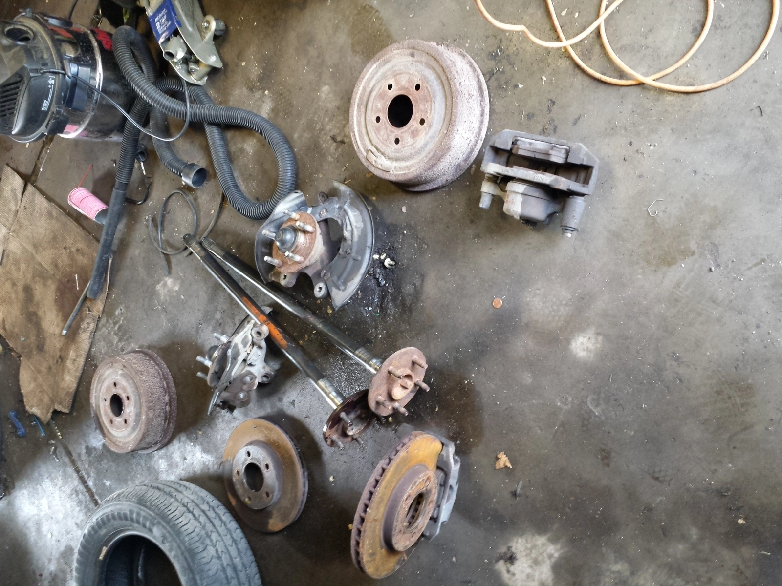

This was my first pile of parts I picked up from you pull it. Then I decided since my cars already down why not convert to rear disc, so I returned the drums.

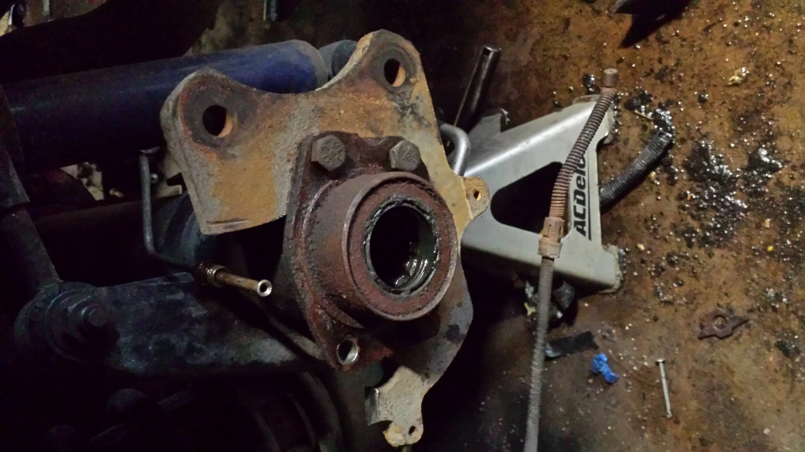

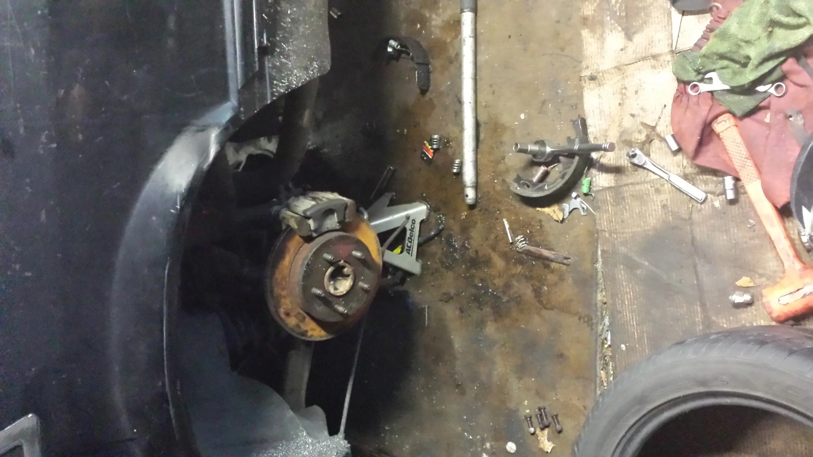

And there you go all together. I just have to modify my brake lines to work with the rear calipers then install my sn95 MC, booster, and prop valve. Then we should have brakes!

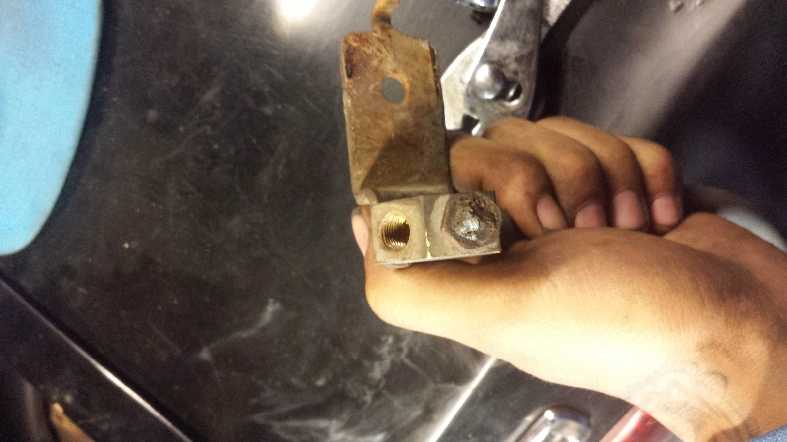

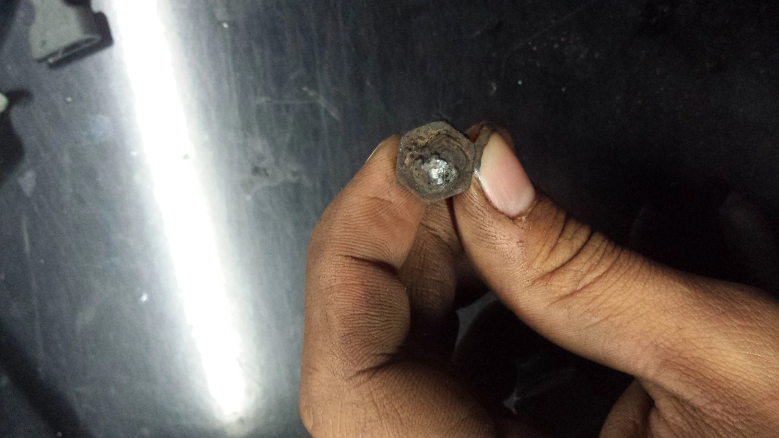

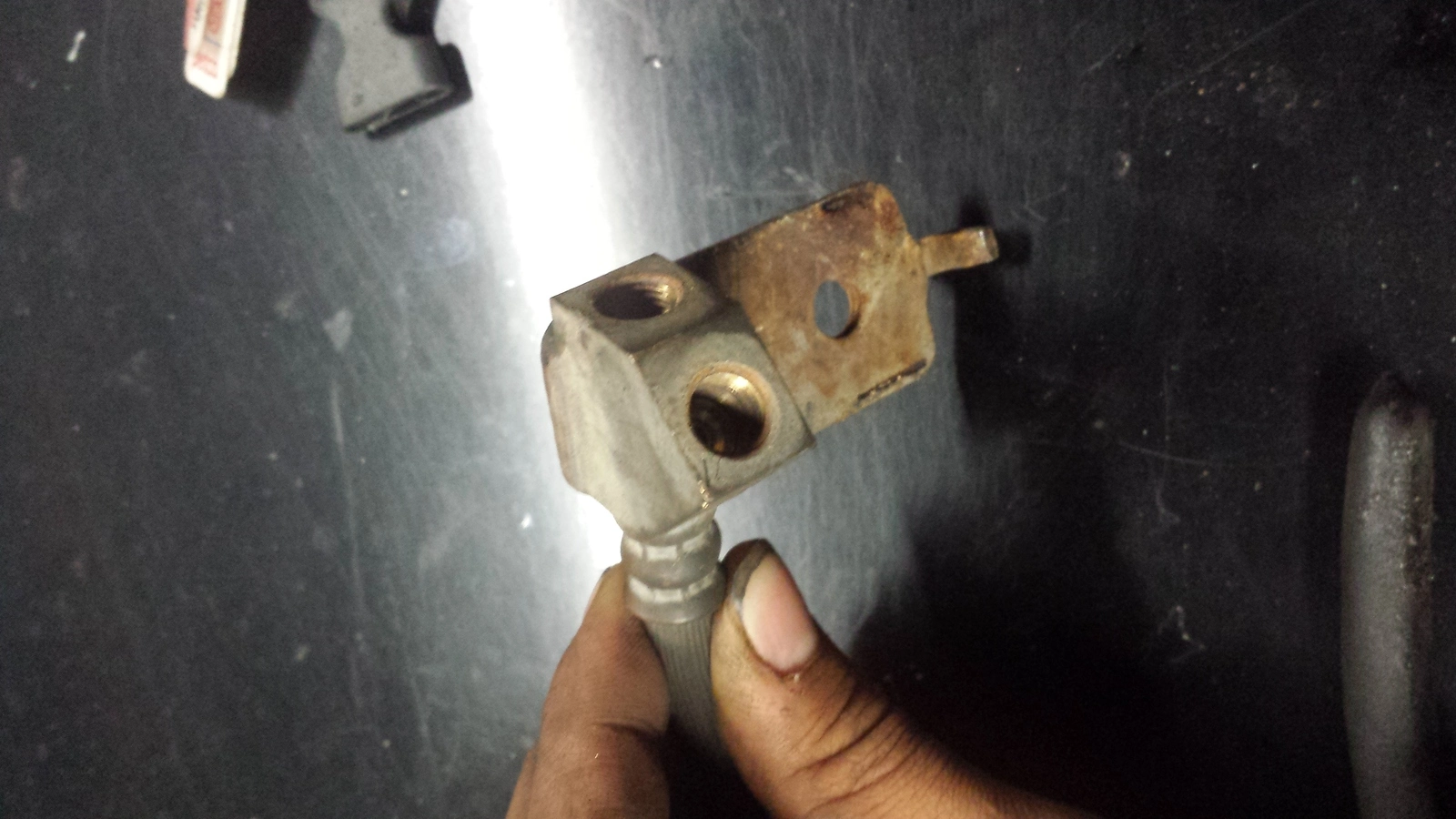

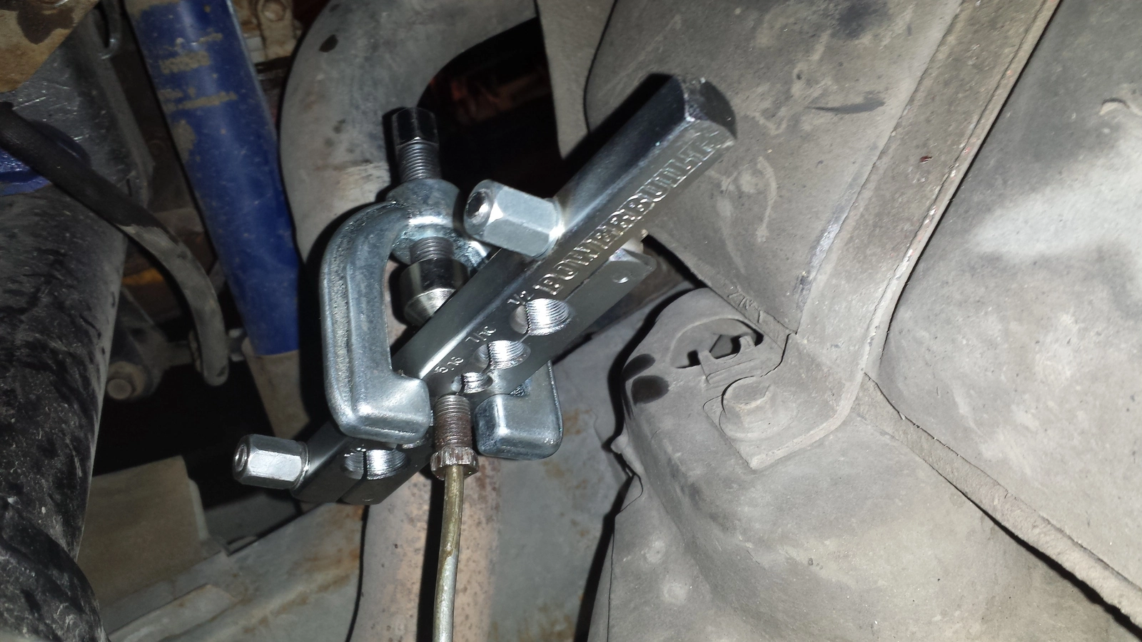

Ok so on the passenger side of the sn95 the brake line splits off into 2 lines and on the fox it is just single. This is how I went about fixing that
