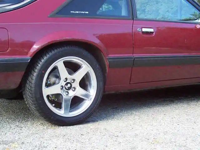

I had the kit from 5.0 resto returned. My dad says the box was a mess, with open parts that seemed to have been just thrown into the box with gear oil bottles broken open. He says it looks like its traveled around a lot so maybe I'm not the first to return this kit. After this expierience, I have lost a bit of faith in 5.0 Resto. They were good when they started out but now they are so big they can afford five pages of advertisement in several mustang mags. Anyway, I got a kit from Steeda and it was a bit more expensive and didn't include any gear oil, but it used name brand parts, not to mention it worked. If anyone is getting a 5-lug kit get it from Steeda, not 5.0 Resto! The Edelbrock 454 wheels look great with the Twilight Blue paint. Now I need some crome bullet mirrors to complement the spinners!

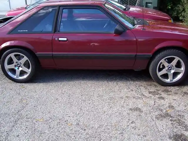

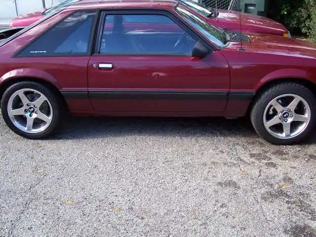

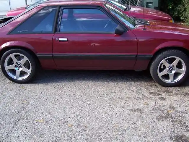

The rears are ranger axles with Lincoln mark VII rear disc 10.5". I just followed the guide online and it worked out pretty good. The fronts are twin piston 99+ mustang calipers on sn95 spindles (to keep the correct spacing).
Springs are stock on the front and back, though the back have been cut in order to get rid of the 4x4 look!

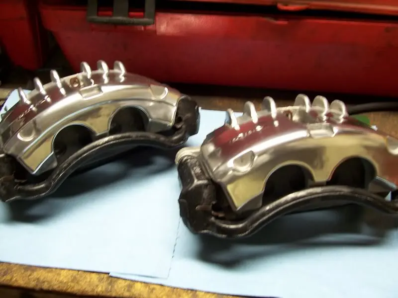

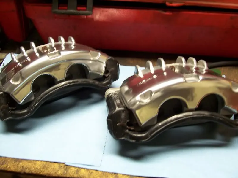

Front PBR (99+ mustang calipers , hand polished)
