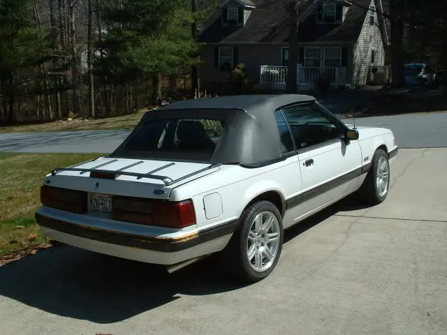

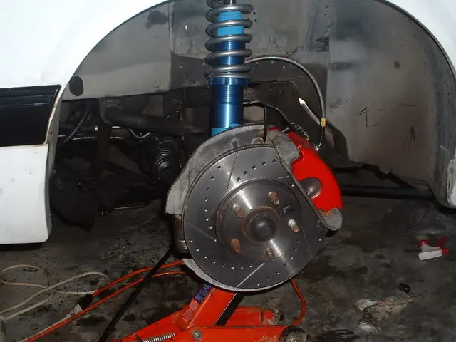

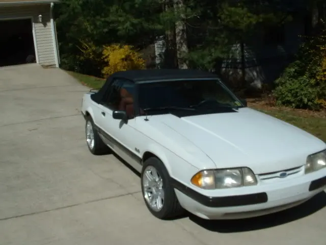

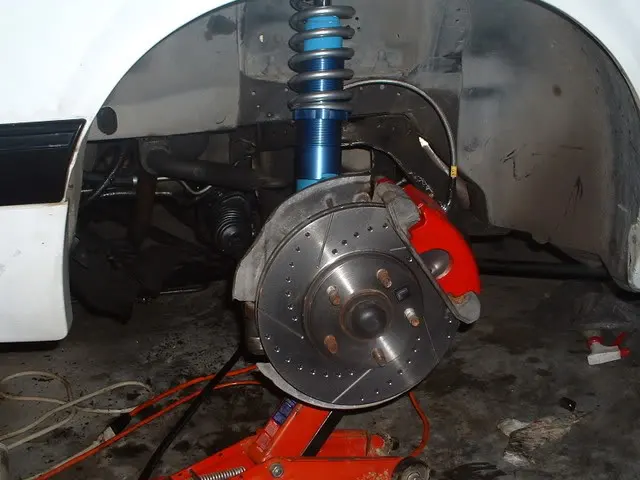

Mine cost $200...with Ranger axles and drums..I splurged and bought the Maximum Motorsport Steel Braided lines that bolt right up to the SN95 caliper. Easiest way to go. The MM lines are $75. I also bought the Ford Racing Rotors which were $140. This brings the total $305.
Kelly

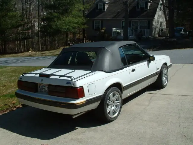

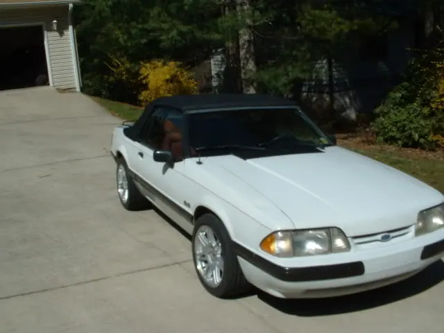

Ps Get the 94-95 spindles or the front will stick out past the fender. Or you could get SN95 rear axles which are a little longer than the fox axles. Look at the front wheel how it sticks out a little more than the rear..These Spindles are from a 98
V6. Which is the same as the V8.
Kelly
