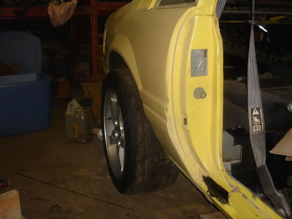

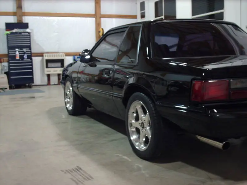

Here is what 17X9 +24mm offset wheels look like with the 2001 axle....so just picture them sitting inward 3/4" if I used the 94-98 axle....(but they would still sit out 1/8")
REAR:
This sits out 7/8" of an inch...which tells me having a 94-98 axle would bring it in 3/4"....still leaving the tire sitting out 1/8")
