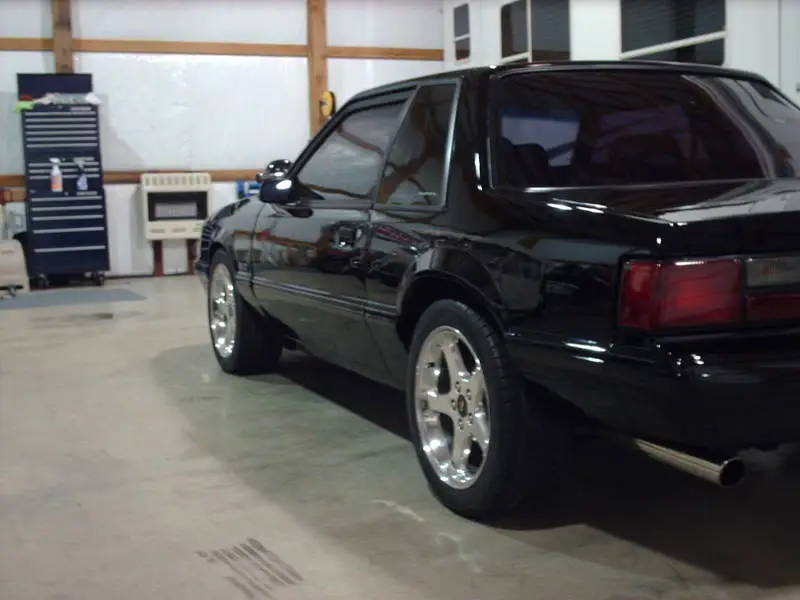

My car with a 1994 model front spindles, fox a-arms ,1994 rear end and 1999 17x8 cobra wheels, think they are 30 mm offset
