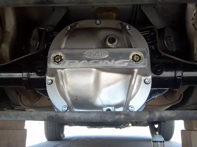

I used a stock 88 form a fox. welded my axle tubes to the pumpkin the sent it out and got it powdercoated black. and I have a Ford Racing aluminum diff cover.

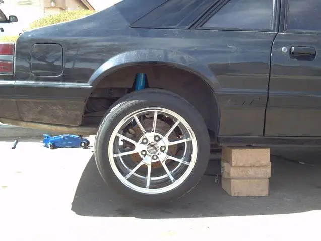

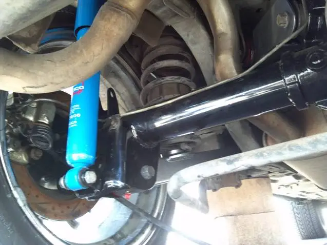

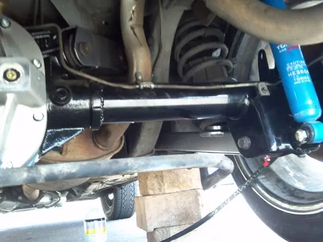

I will have to take some pics of the front and brak master cylinder and stuff

The brake lines i9n the pic are mocked up I changed them out. I dont have the Eibachs in the rear yet in the pics cuz i hadnt rolled the fenders yet. I am running 17x10.5 with 275/40/17 tires.

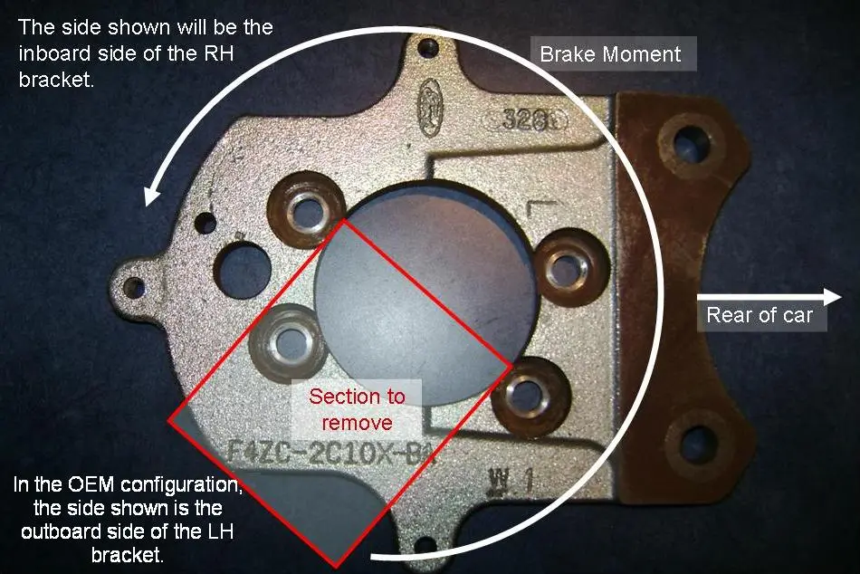

You can save some money and just modify SN95 rear caliper brackets. I haven't tried it yet because I'm still rounding up parts.

What will cutting the bracket up gane you? I dont see how that would get you anywhere. Im curious on this one. Always will to learn new things.

There was a write up on that modification to the bracket a while back. I am a little apprehensive about doing it but someone on here has had success with it. I would rather spend the money on Northern racing brackets and be done with it.

Cutting the bracket allows you to install each bracket on the opposite side of the car. Installing them that way, gives the bracket the correct spacing for the calipers.
It works well and I've never heard anyone say there's been a problem doing this, however....
I'm with this guy.
