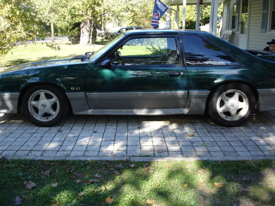

I hear u guys about doing things right the 1st time...Thats almost always my view on my projects, but being that this 5 lug swap thing is adding up pretty fast, & with Xmas right around the corner, i gotta stop buying stuff for myself & think of others for a change... View attachment 290940 View attachment 290942 View attachment 290944
Since it wont hurt anything to leave out the MC/ PV/Booster swap, I will just upgrade after Xmas if I dont like the way the brakes feel, unless I win the lottery within the next few weeks... Besides, I still need to buy an install kit for my 3.73's, & balljoints 1st...
you could but that's wouldn't be the best thing to do.. if you CAN AFFORD to the mc/pv than do it.. if not than just do the pv but when you get the money than do the mc..
my plan with my car is to do autoX as well. my plan is to put a irs setup in my car with a full maximum motorsports coil over setup... right now on my car i have eibach sportline springs and i absolutely love them.. my car is a dd and i don't have any problems with the eibachs.. they lower are cars perfectly!!! i have had H & R super sports, eibach pro kit, and eibach sportlines and they are my absolute favorite.. i also have maximum motorsports caster camber plates and monroe sensa trac struts...
Nice ride, sounds like you have a lot of work ahead of you! Now I did a little reading...I want progressive I think. My ride is pretty stiff as it is, I don't really want it getting any worse, you know how bad the roads are here :nonono:.
