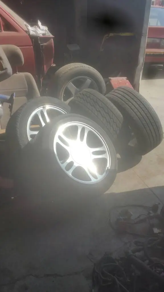

picked up these 17s from a 97 today and ordered the new brake lines as well as some poly bushings. Figured I would upgrade those since the cars been sitting since 2004.

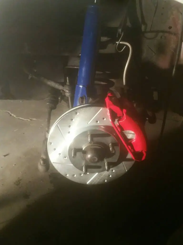

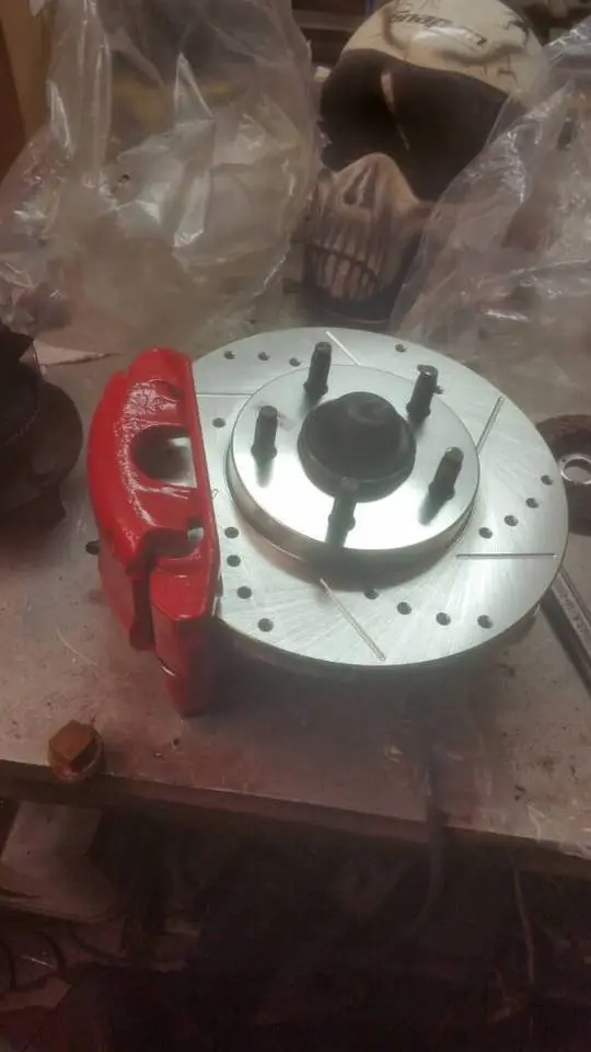

Well after piecing together all the parts I believed I needed I was able to complete the front end portion of the swap in 1 weekend. The parts used were:
SN95 spindles
SN95 ball joints
Poly bushings (maximummotorsports.com)
Fox to SN95 braided steel brake lines (maximummotorsports.com )
Powerstop evolution brake kit (pepboys.com)
OE replacement Monroe struts
Caliper mount bolts (autozone)will give part number later
All things considering went smoothly (unlike my last 2 projects) only replaced the struts because 1 was leaking.
