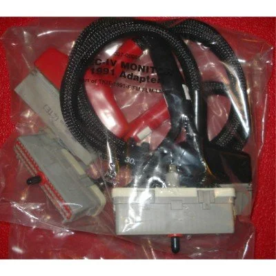

I saw that @Mustang5L5 is going to incorporate the Ford 007-00081 Rotunda EEC-IV Monitor Adapter into his DIY MS3 Harness.
@a91what, I bought one and am wanting to use it to extend my Pimp harness. Only concern I have is that the wires are a thinner gauge than almost all the ones in the pimp harness. Should I be concerned?
PS I’m using a Ron Francis Pimp harness
No, I never had an issue.
None of the wires carry a significant load.
